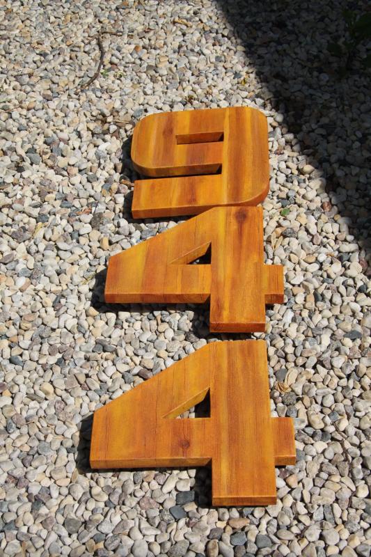

    Hi, 12" high numbers out of 18lb 1" HDU made to look like cedar.

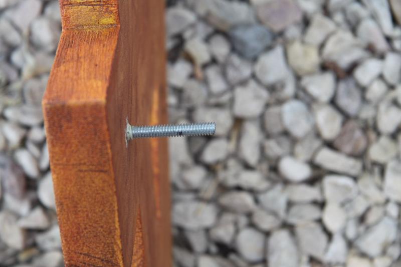

    Epoxy pins set in the back,

  9. piccadillysigns
    piccadillysigns Member
    131
    Jan 31, 2012
    Thank you so much guy's for your kind words.
    I had fun creating the numbers, my client had just finished building a new cedar deck and called us to see if we were up to the task, tis, tis, we are always up for a challenge,

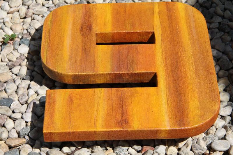

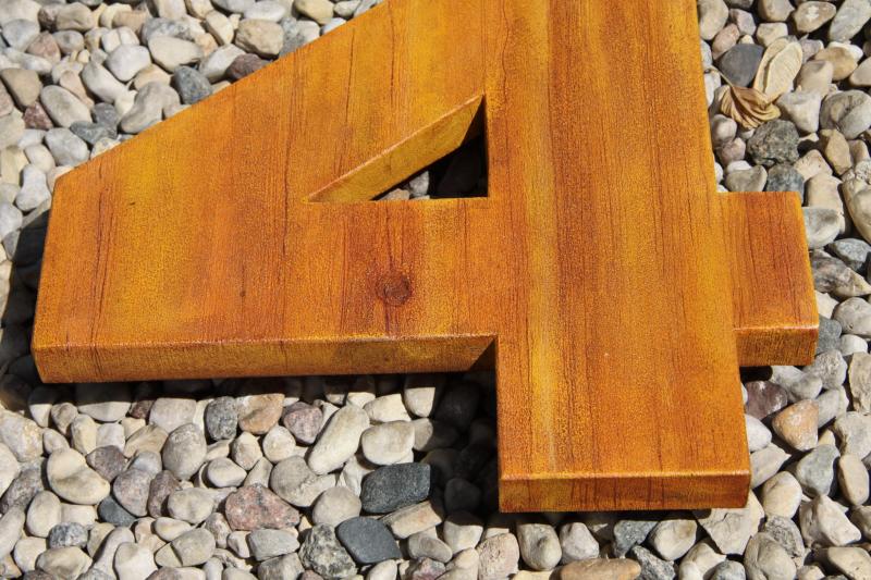

    The Font is Bolt Bold, 1" Hdu 12" High. from start to finish about 4hrs of work and then a couple of days in between for the clear coat to dry, as for the painting the client had requested a vertical grain looking like it was cut from one piece of Cedar, after the priming I start with light colours and work up to the darkest and wiping some of the colours off the surface as i go, there is about 6 colour washes or glazes in total, and then just adding some of the grain detail last. The client wanted to install them so i had provided a printed template with the pin placement for easy installation, should be going up this weekend.
