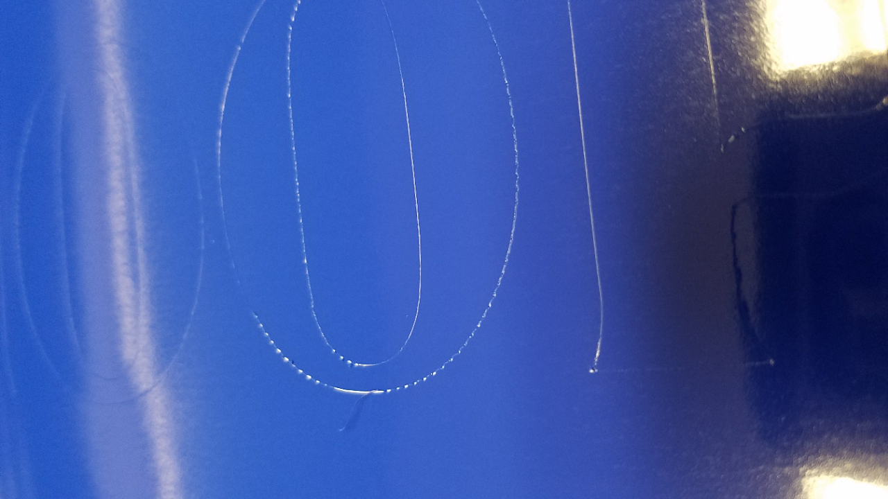

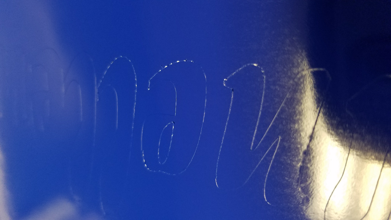

    Help... Cutting issue Roland GX-24

    Holy cow. I mean are you totally new to cutting plotters? It looks like the tip of your knife is broken.

    Nop 7 years ago

    Perforated cuts are usually caused by a bad cut protection strip. It could also be a bad blade holder. You can purchase both at RolandDGA.com.
