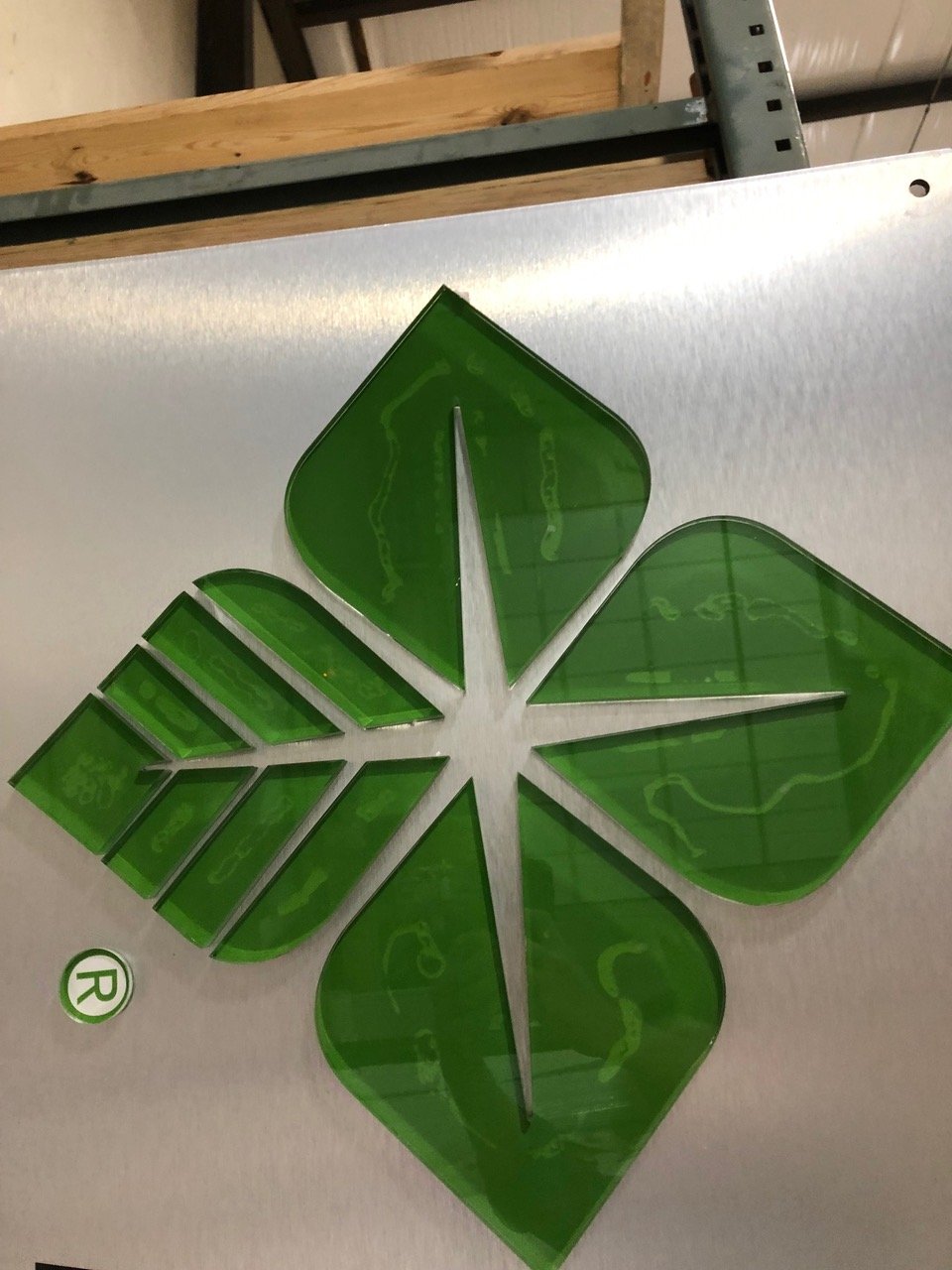

Hi. Looking for suggestions for mounting polished acrylic with a vinyl back to signabond.
We have tried 3 different versions.
Version 1 using locktite adhesive behind the vinyl and applied directly to the signabond.
Over time this pulled the vinyl to reveal adhesive location.
Version 2 using double sided tape on the back side of the vinyl and applied directly to the sigabond.
Over time we experienced the same issue of the adhesive pulling the vinyl.
Version 3 we placed the vinyl layer to the acrylic, another black vinyl layer to the back and double sided tape to the back of the black vinyl and applied directly to the signabond. Once again over time the adhesive begins to pull the vinyl and shows through on the front. Anyone have suggestions of applying without showing adhesive?
