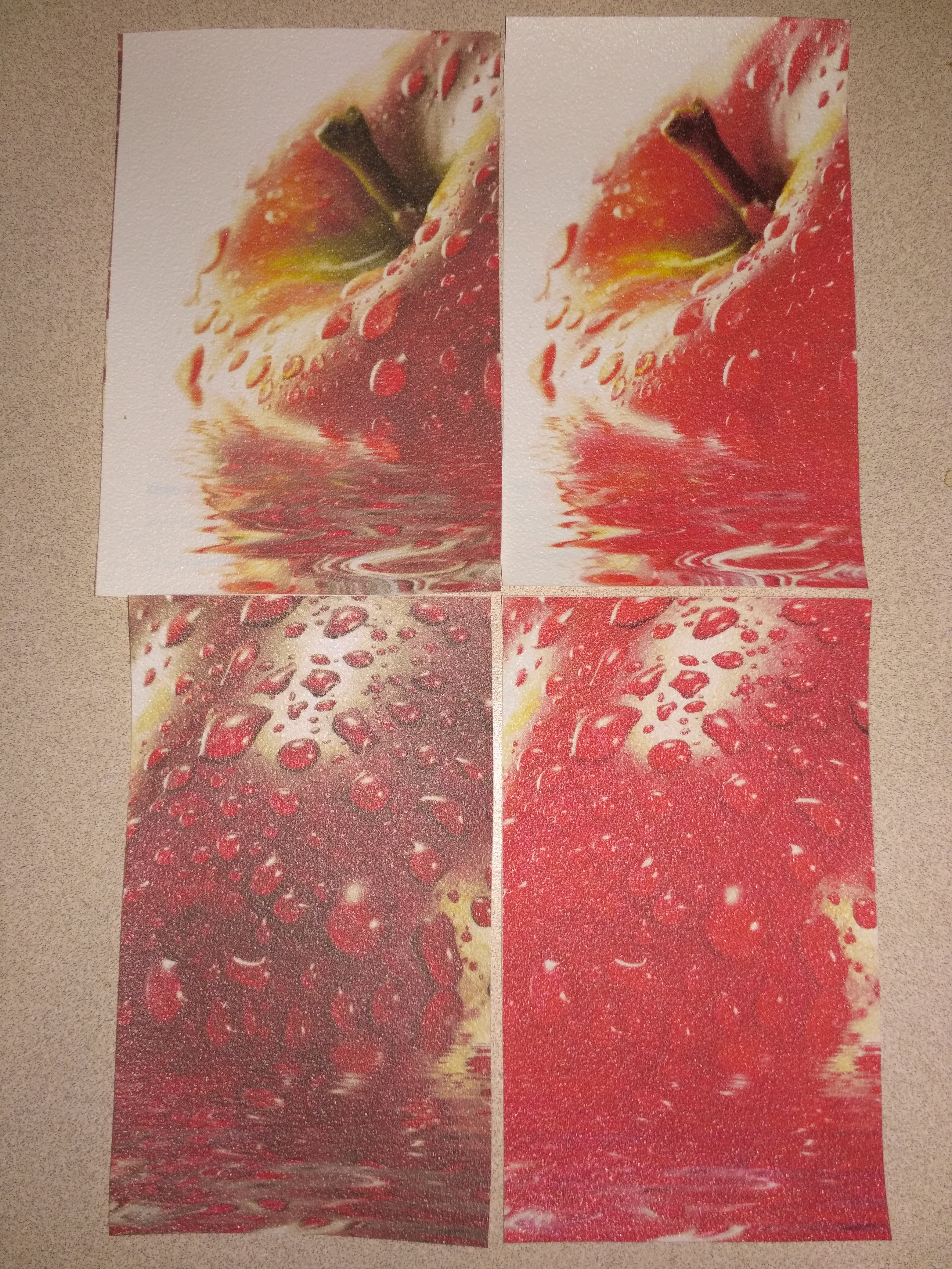

  6. Fodin
    Fodin New Member
    1
    1
    Thursday
    Russia
    I've tried to print an image with color correction (right side) and with linearization only (left side).
