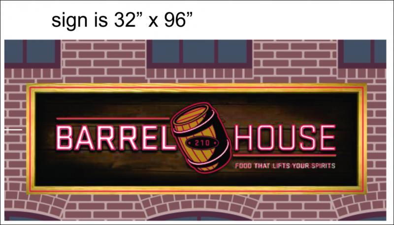

previously done same outdoor sign for customer as digital print on alumalite. now customer is opening another location and wants same sign/design as before but with red lighting as shown in attachment. never done anything like that before - not sure if led is way to go or can neon be this small? any help on how to tackle this or who to go to is much appreciated.

What are your letter heights and stroke widths?
Is the entire sign face digitally printed and the red lines are the illuminated portions?

Moze, the red lines indicate what the client wants illuminated. the largest letters "Barrell House" are 7" tall and the red stroke in artwork is only .33 inches. The smallest letters are 1.5" and stroke is only about .1.
not alot to work with. in reality, don't know what can be done, hence my post. any more feedback would be great. i need to get back with client and tell them what is doable or what is not. if there is a size limit to led or neon, guess thats what i'm after.

Yeah I dont think you can do all of that with exposed neon strokes, but definitely doable with push-through and backlight

It's too small for neon and LED's at those dimensions.
If they want those specific areas illuminated, I would build it as an acrylic panel and just route those specific areas. Then edge-light the panel with red LED's so that those etched areas show red. Cover the rest with digitally printed vinyl and the areas where the routing was done would be weeded out from the vinyl.
It wouldn't be as bright as neon or LED's, but it would give the desired effect.
