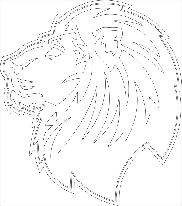

    Inkscape™ with default settings. :omg2:
