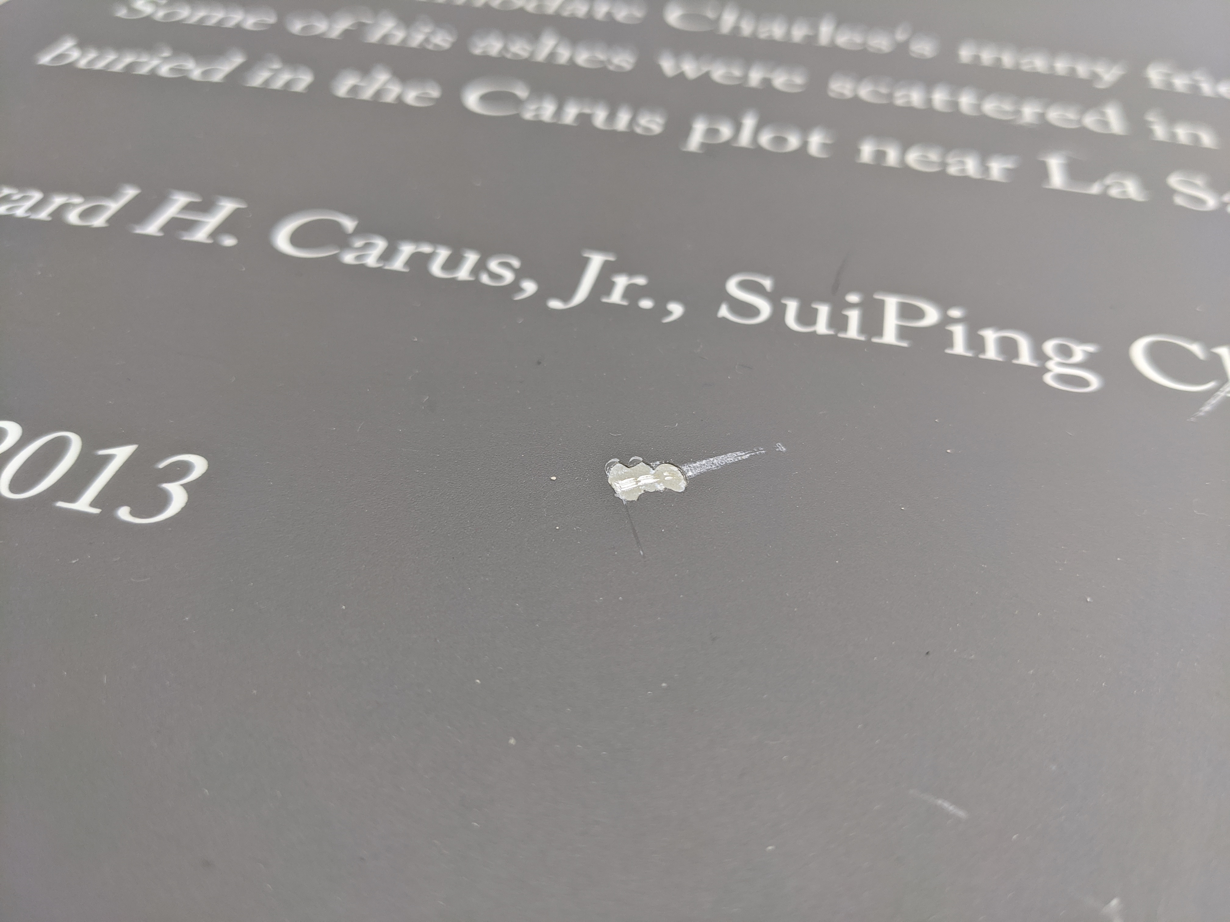

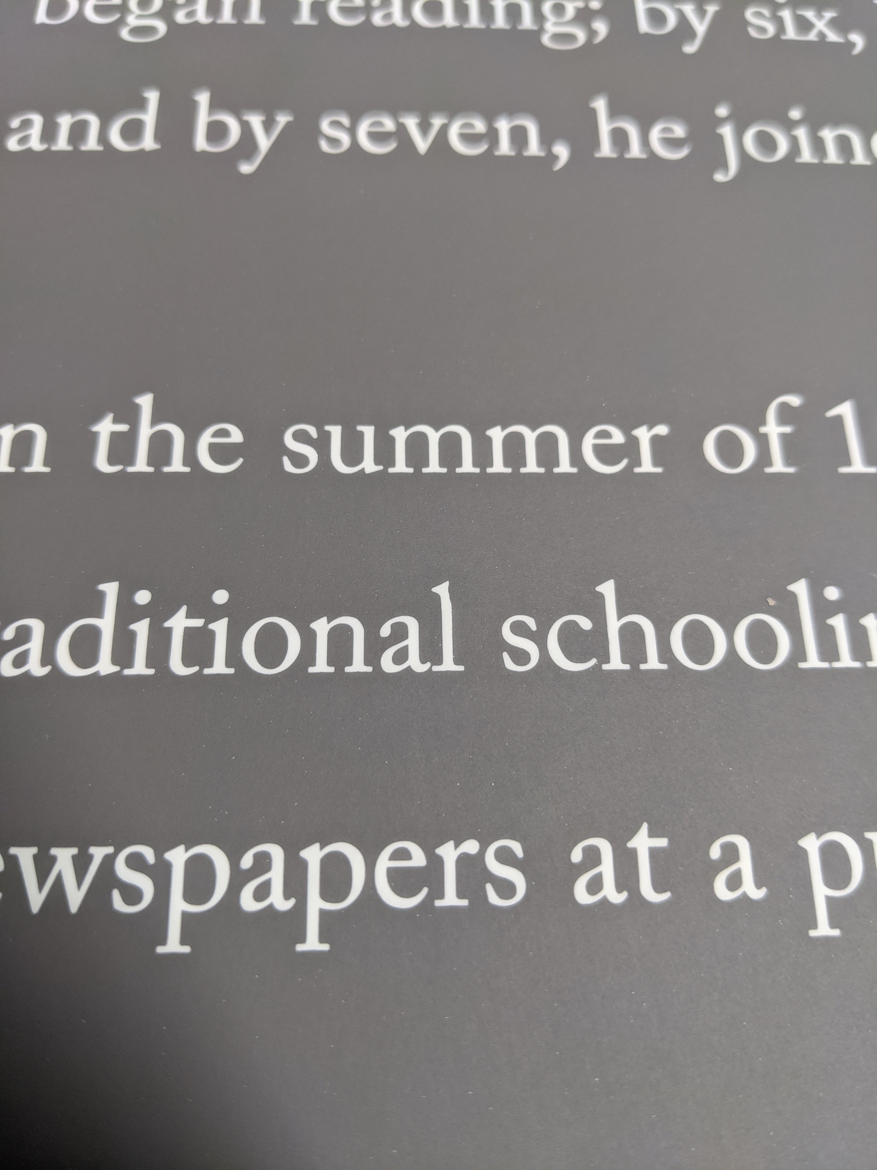

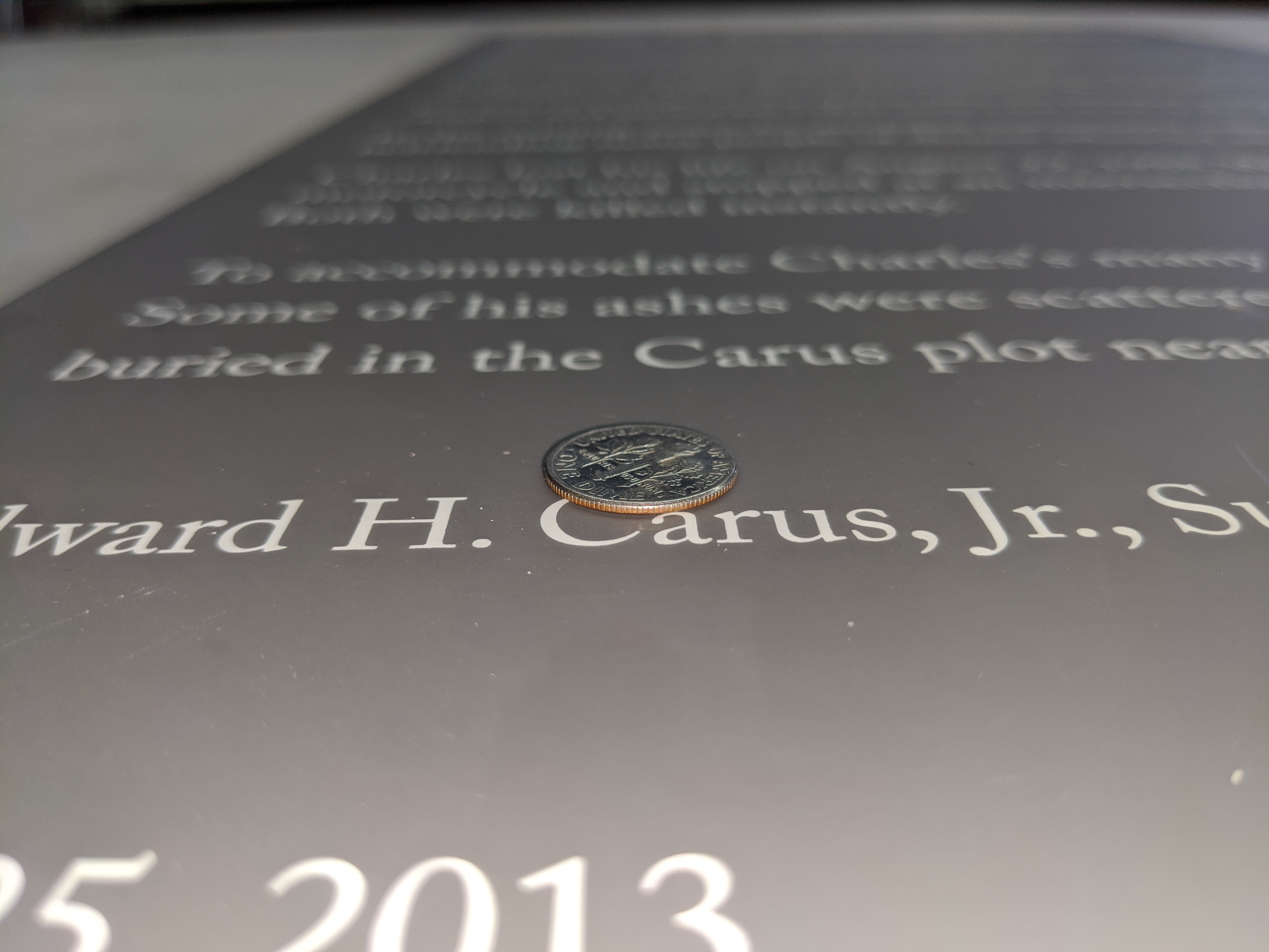

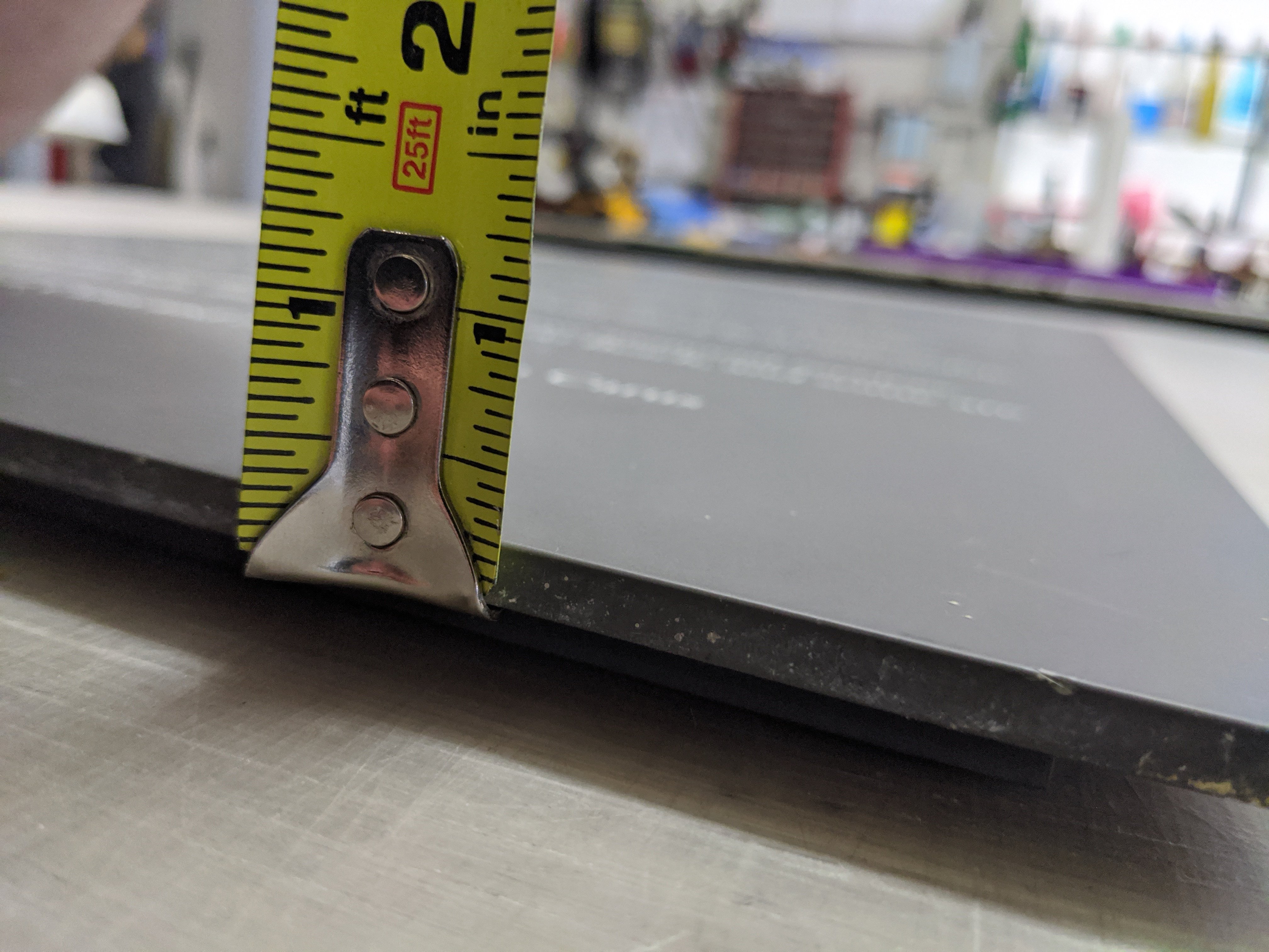

A gallery customer brought this in and would like to redo it. They've been through about three or four people since this sign was made, so they don't know where it came from. It's 1/4" Aluminum attached to a 3/8" spacer which was VHB'd to the wall. Mounting process and material aside, I have no idea what this is.

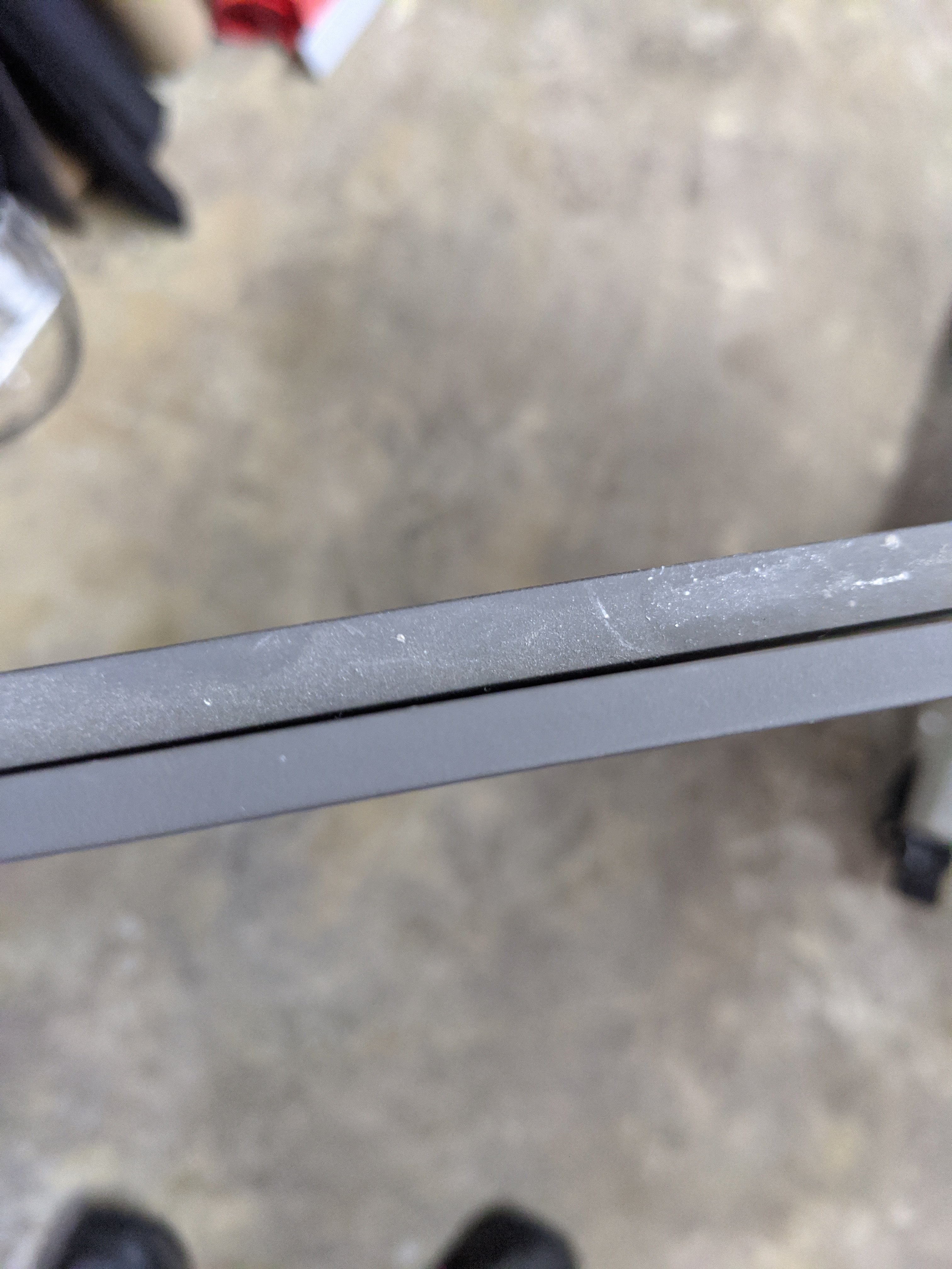

It appears to be over coated in a smooth satin finish of sorts. In one of the pictures where there is a chip, you can see how thick layer is. I'm at a loss. I said screen printed on the phone, but this doesn't look like any screen printing I've ever seen. I don't know. I really just need to know what this is so I can send it off to get redone.

Looks like dye-sub. You can get prepped dye-sub aluminum from some suppliers, but I've never seen the coating that thick.
unclebun
The gray coating looks gray all the way through. When you dye sub, the color is usually just in the top, not all the way through a thick coating.

Yeah, the coating and the white letters feel as if it's one layer. It's really hard to see any dept difference between the two colors. I also think there is the clear coat and then a coat of pewder color, and then a primer underneath that.
2B
With that "chip" I would say powder coating or a like process.
but those are crisp font edges

Yeah, that's what gets me. There are no depth ridges, they are super clean. I dug into the white and didn't find any pewder color underneath just the primer. So I don't think it's painted and then the white painted on top.
All the layers combined are ~0.0115. I did find a defect in a letter, if that helps in any way. The letter "l".

Looks like 0.25in solid aluminum spray painted gray with flatbed printed white lettering. Gemini should be able to do this .

From the pictures it almost looks like some type of phenolic or formica printed on a flatbed.

That texture appears to be a rolled paint, the defect in the L looks a lot like a positive vinyl mask that didn't seal near the edge.
So my guess is: 1. Vinyl lettering applied to substrate 2.Sprayed then backrolled paint 3. Vinyl letters removed 4. Profit?
My vote is some sort of an epoxy process. Stenciled lettering like a screen process, spray painted and then a finish coat or two of a clear of your choice. That "L" is a give away that someone messed up the stencil. either before the paint went down or while pulling it up.
