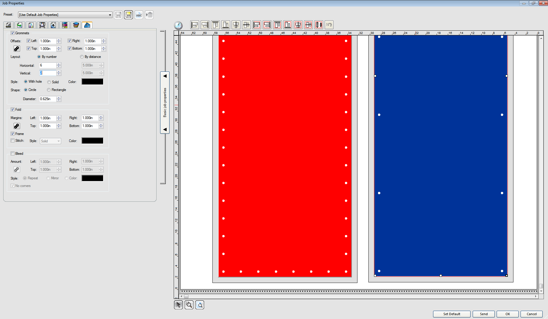

You need each banner as a separate file.
Drop the 2 files into the Program Manager.
Nest the 2 files
Adjust your finishing options by selecting the banners one by one.
Seems to work in Flexi 12 (Mutoh edition)
