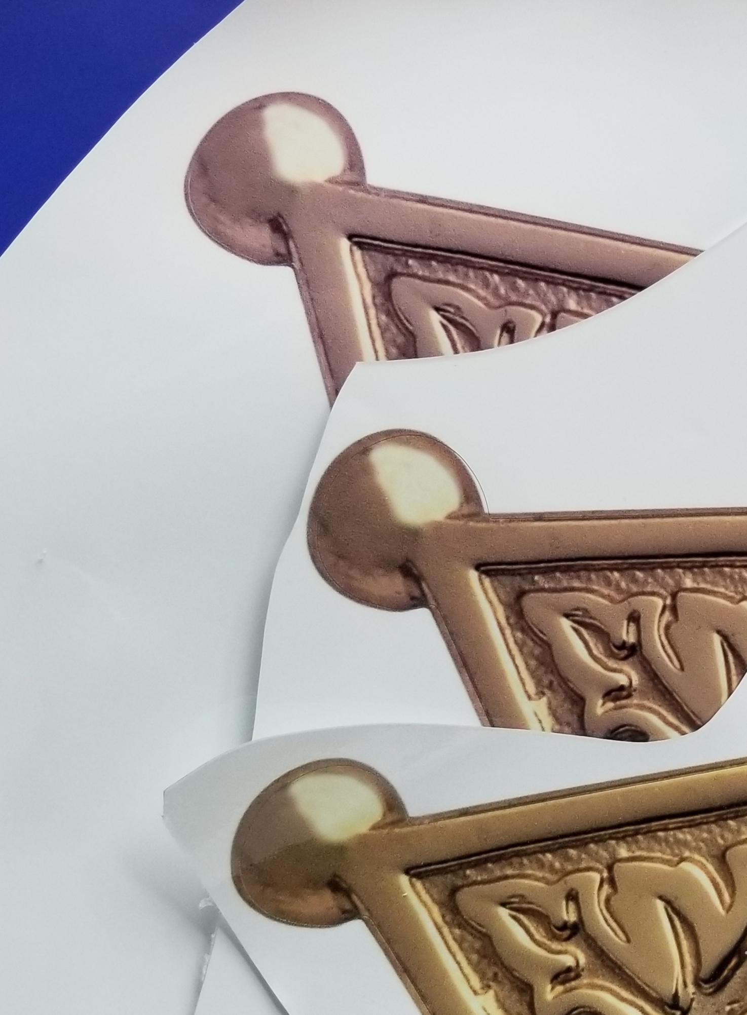

Hello, looking for some suggestions. I seem to be having some color consistency degrading with Yellow / Magenta over time.
Item in the front is probably 1 year in age, then the middle is 2 months old, than the back print is from today
The Optimize Print Quality maintenance ran successfully, and I saw no issues with the ink.

My inks are expired, and I did replace the yellow, in both ink tanks, re ran color calibration, and still my images looked washed out, and the yellow seems undersaturated. If I add a Mulitply 35% of pure yellow over the image, the color looks accurate.
I have never shaken the ink boxes, but definitely will going forward, yes the new Ink boxes say to rotate or shake them.
I am not sure if the old yellow is possibly still in the printer? do I need to print a solid yellow to "flush" the yellow perhaps?

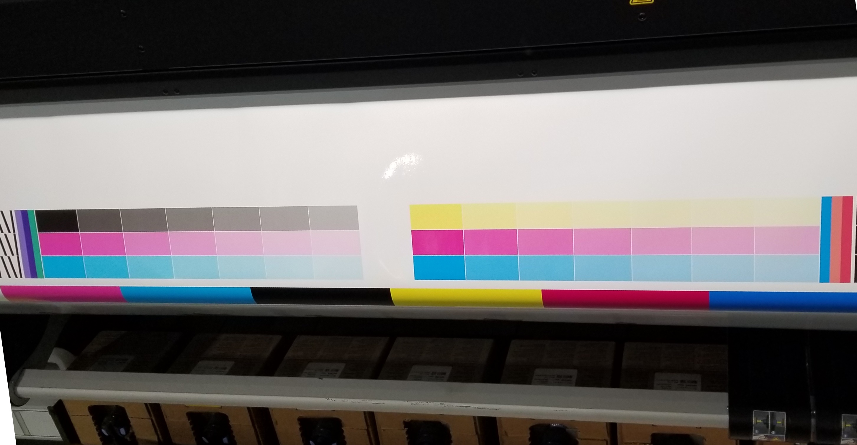

The Print heads mostly have 1200ml to 1500ml of ink passthrough.
The Large Print Cartridges are from the initial HP 570 setup at 6/1/2018.
The Files are the Same, the media is the same (Avery 1105) Profiles are the same.
Does anyone recognize such color inconsistency?
Change Print Heads?
Change Intermediate ink tank?
Change Ink Refill tank?
any help is greatly appreciated!
Jake
Are you running a color calibration before running each of those?
RaymondLoewy
Pretty fly for a Sign Guy
I would change the head even though 1000+ ml is not that much, it may be from not printing enough. I have had similar problems with the HP 360 having the Y/M heads give out. Sometimes I can get these HP heads to last past 4000ml, other times I find I am having to swap them out around 1500ml.
I would also suggest you check the printers altitude setting to make sure it is right for your environment.
