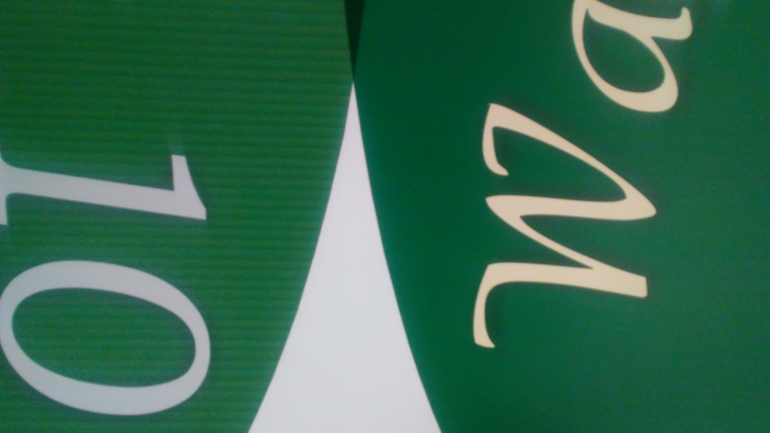

    I've had a recent issue with our HP FB700 with banding. And it's only on the first print it does, or sometimes right after a cleaning in the middle of a full day.
    It's as if the 3/4 of the nozzles are clogged, but the jet health pattern and everything is fine. If I'm printing 2-sided 4x8 sheets, the first side will look horrendous, and then flipping it over to print he second side, everything looks fine. The only difference being flipping the sheet over. And every sheet after that will be fine as well.
    I'm not getting any errors either, which is annoying.
    [Reminds me of when we had a cable issue at the house - perfect service during the day, but at night it was shoddy and frequently kicking us off. Turns out there was bad connection and during the heat of the day the metal expanded enough to make a good connection, and when it cooled off at night and shrank back, bad connection. ]
    I've already done the usual things, restart, cleaning-auto and manually, cussed/threatened/sweettalked/talked dirty to it, checked to make sure all the heads were seated correctly, etc.
    Any ideas? I'm not dead in the water, been printing a scrap sheet at the beginning of each run instead of waste good stock, but it's not a long term solution.
    I'll try to get some photos later on today if it's helpful.

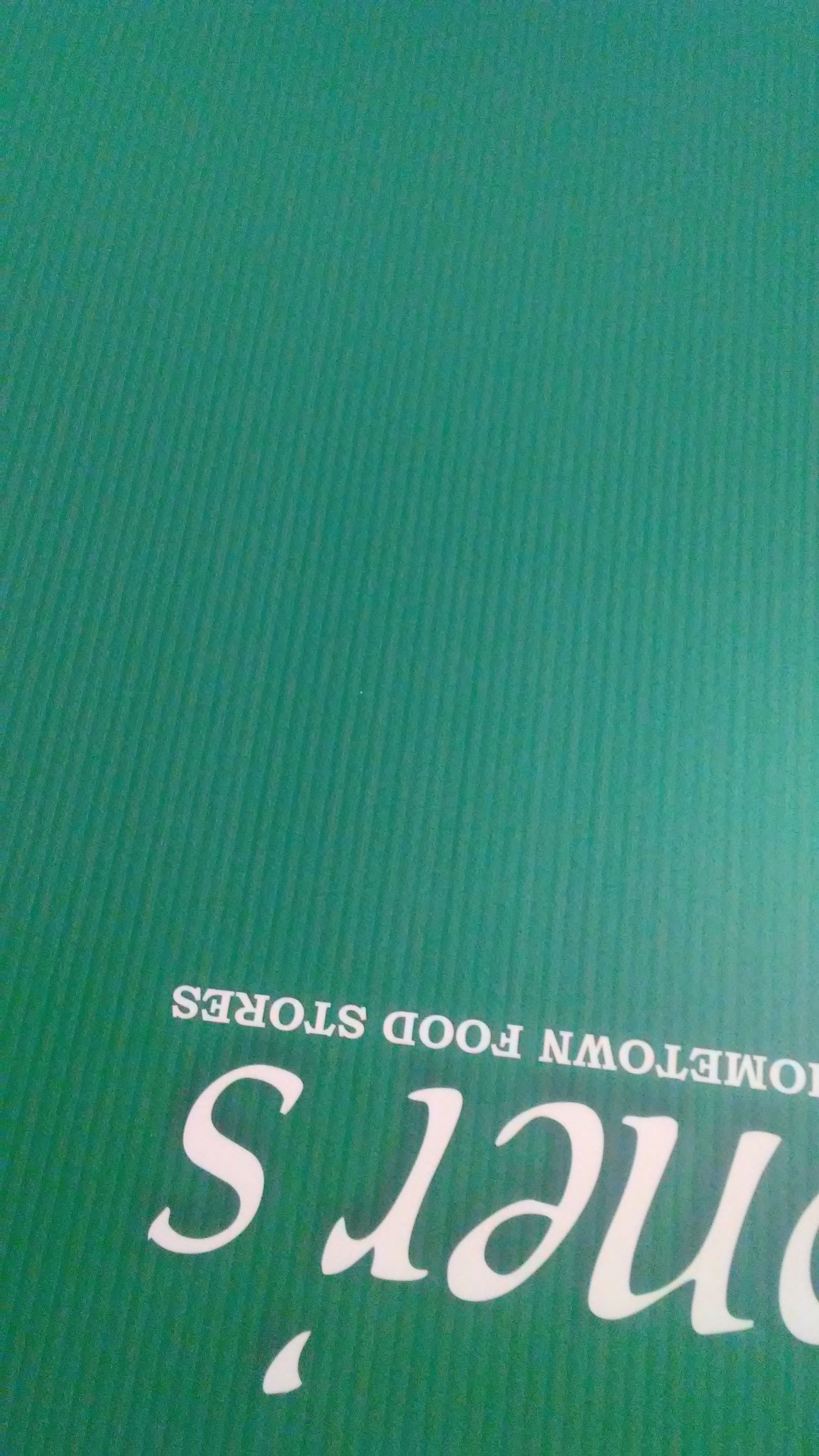

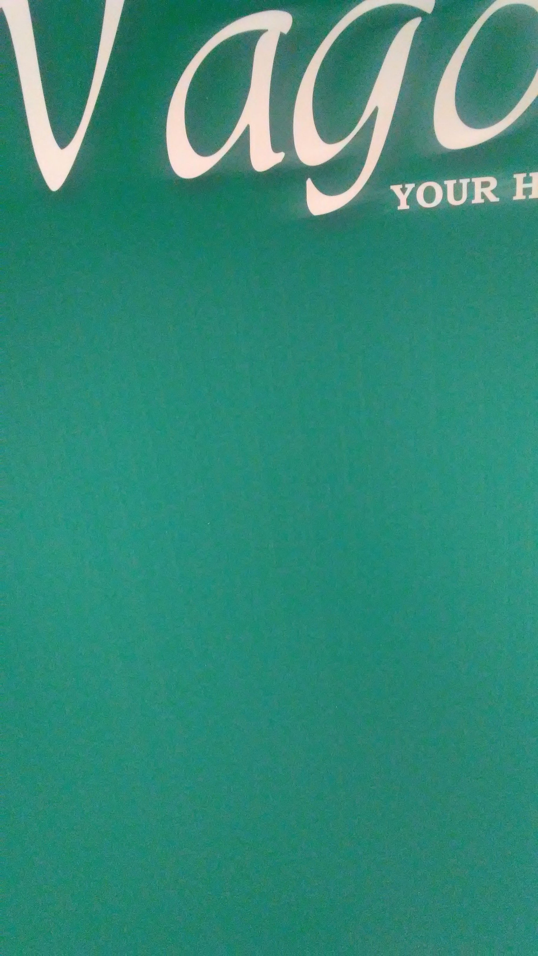

    The print on the left is first one out yesterday morning - nearly perfect nozzle check yet it prints like that. the one on the right, is just flipping the sheet around to the other side. It has been doing this every day the last week or so. And I did try just running an extra cleaning in the morning, even tho it's left on to do auto-maintenance all the time, no change. Sometimes the 'bad' print is worse than this - but I do nothing in between the bad print and good print other then load/reload stock. no cleaning, no adjusting nothing. grrrr, it's being quite contrary.
    Any suggestions are welcome :) and feel free to ask the 'stupid questions' - I can't count the number of times I've been tripped up on the little things.

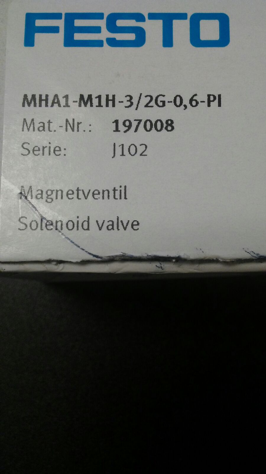

    You can replace just the solenoid/valve. They are made by Festo. I've attached the label from the box for anyone else who may have a bad solenoid and not want to deal with the whole manifold replacement.
    Popped that in and back to work, finally. Just in time as well! whew!
    Once again, thank you all for you helps it did help with tracking down the issue :thankyou:
