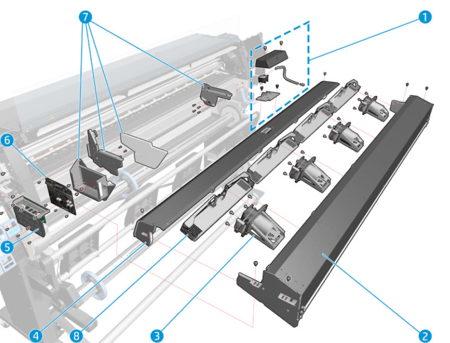

So you need to remove the plastics from the left and right side of the heater. Then remove the cover (4), it has just the screws on top and two on the sides. You have to remove the top piece as well (1).
Then check all the heaters (3) if you see any issues and cabling as well. You can also swap the heaters around but mark them first because they are basically calibrated to that position.
The heaters have 6 screws if I remember correctly. That piece of metal shielding needs to come out as well.
Try to find out which fan is going hay, is it one of the heaters (3) or one on the front? Probably one of the heaters is coming to it's end of life and barely going on without error code.
You need to tell me your serial number to see the correct part number. Parts I think you can even order straight from HP.

You could do the same as what I already said. This code points to the most right side (front panel side) heater temperature sensor. That temp sensor is embedded in the heater.
I would check the cables that it's all good and properly connected and then swap the two heaters on the right.
If the temp sensor is faulty your code should change to 16.12:10.
I don't remember exactly but that heater is something like $300 so not too bad? Pretty sure the heater just needs replacing.

Swap your heater with a new one. Common issue with the 310. It’s a very easy fix and certainly well within basic capabilities with no special tools or post calibration required.
Part should be in the $300 range. Save the extra cash and treat your employees to a nice lunch on Friday.
