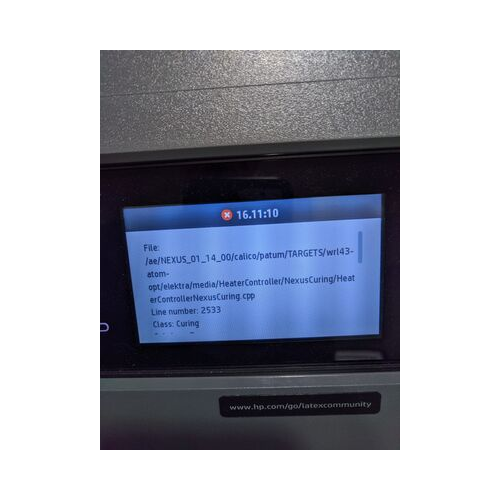

MonkeyB0y thank you! Here is a summary of what is happening.
The printer appears to have trouble holding temps on the curing module, but not all the time. I've blown out the fans and made sure there isn't anything in there causing problems, I've wiped/clean the curing module on the outside, etc.
Sometimes this happens 3 or 4 times a day, other times I can go 5 days without an issue. I can tell when it is going to happen, I see the temps jump up and down and fall, and the fans turn on and sounds like a high pitched jet engine, and then the printer will abort prints and give me the output on the LCD that I've attached.
Any suggestions on what to try/do? Thanks!
chrisphilipps
Merchant Member
TomK GRS has recently taken on the HP Latex printers. The error message in your pictures is pointing to the temperature sensor failing. There is a possibility that the cabling is just loose but I would suspect the sensor it self.
