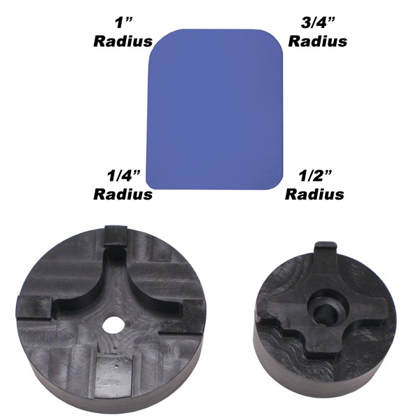

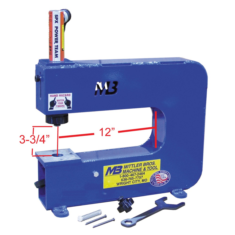

What are your thoughts on a setup like this hydraulic punch? We have a Roper Whitney 218 punch for holes and a million dies but need something to round 080 corners. Was looking for something faster and hands free (air or hydraulic) so it's not a back breaker with larger panels. We have an electric lasco rounder now but its max is 040 aluminum or 3mm ACM

I guess not so popular. How does everyone handle .080 aluminum? Do you put it in a CNC or just working with pre-cut blanks?

Looks nice, how much it is?
I had a similar one that offered all of the same
radius, but it was manual.
Andy D
I can't seem to find a link, but the manual one I bought was around $350 & you had
to get your own press... around $60 at Harbor Freight.
equippaint
Andy D
Yeah, could be... I used it on smaller stuff.
The one-ton press had to be bolted down to a heavy counter too.

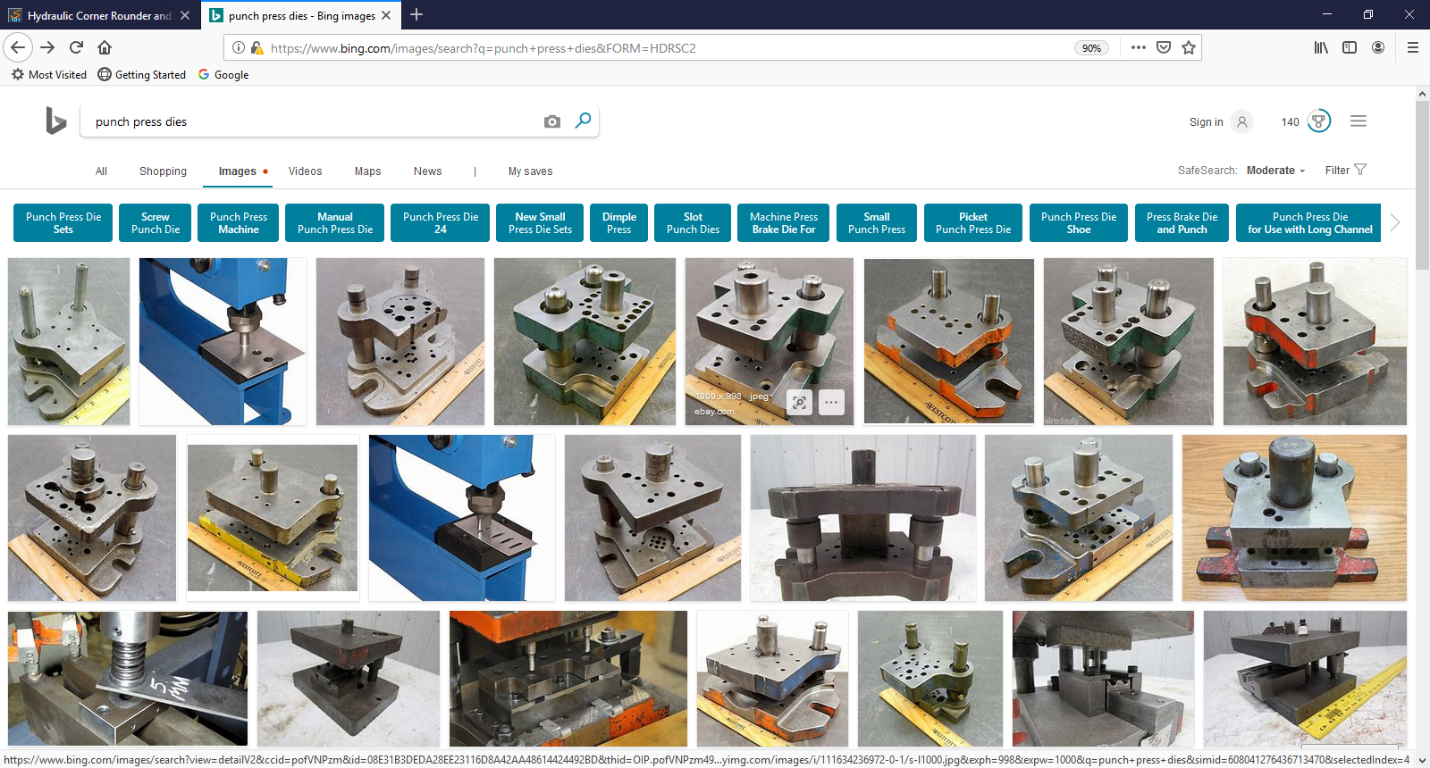

5 ton Fly Wheel Punch Press. Anything from .010 to .125 no problem. Any thicker and you start to have build burr issues. At least with our machine
Something like this.
Find a machinery dealer near you and go take a look. When you buy the machine they will set you up with someone who can handle all the tooling you will need. Most of the time the dies are not a stock item on the shelf.
