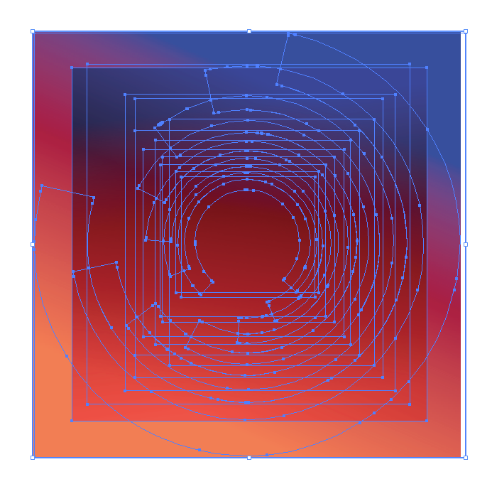

Sure thing, here's a screen shot of it unmasked. The arcs are the actual finished shapes, and all the squares are various gradients. I'm trying to cut it off across the bottom, about where the inside of the arc is at the 6:00 position.

rjssigns
Direct Select and ditch the shapes. Then flatten and rasterize the rest. Should be able to clip what is left over.
Without having the file in front of me it's tough to think of the exact steps.
