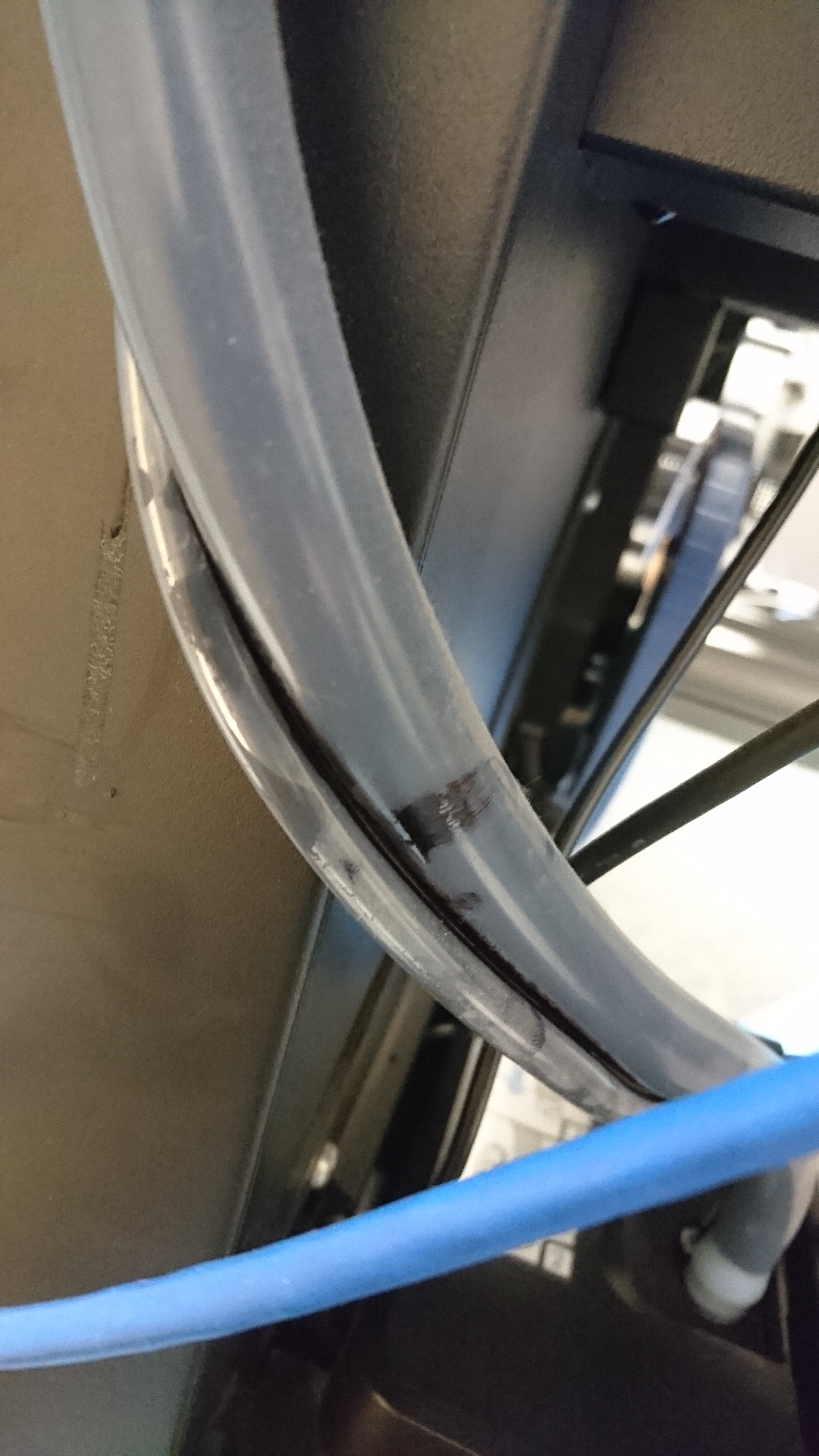

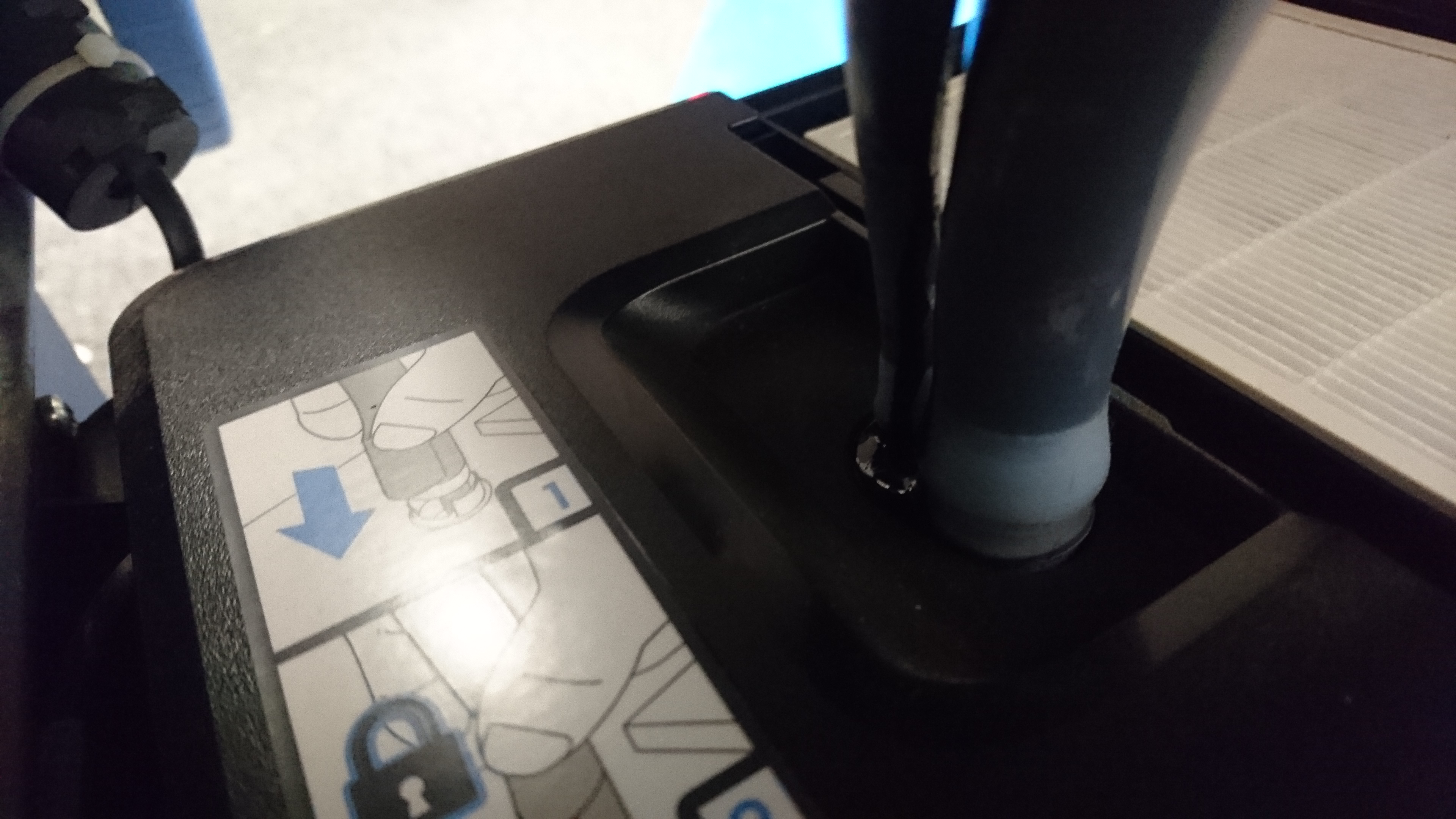

So I came in this morning and noticed that there was black ink on the floor behind the printer. It's an L26500. It appears that the two plastic tubes at the back of the printer are stuck together with black ink. The smaller of the tubes has leakage or an excess of ink at the end of it where it goes into the printer at the bottom.
There was also a little puddle of ink on the floor so it looks like it's dripping from the top.

stealey
those tubes go into your waste tub, is that full? if so you need a new one, could be that its full and the ink has backed up and caused a leak

Yeah, I replaced it and the ink Mant kit after i realised it was at 89%. See if that solves it. Im sure that was the issue. Sorry for the wasted post!
burgmurk
I had the same issue with that printer. It should tell you the tank is full before this happens, but they don't seem to read the levels right. I used to change mine at "90%" but it looks like you should do it a little sooner than that.
