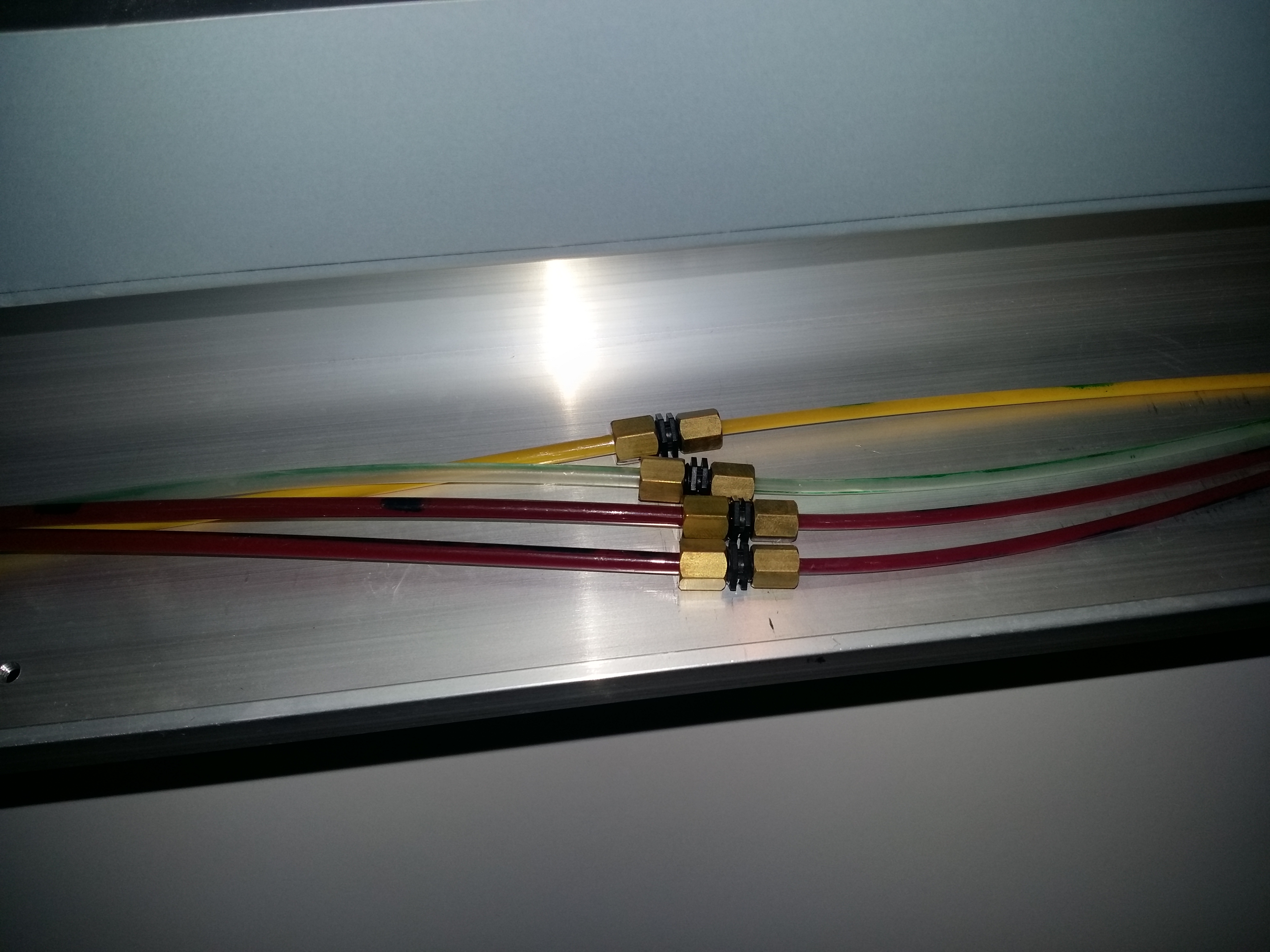

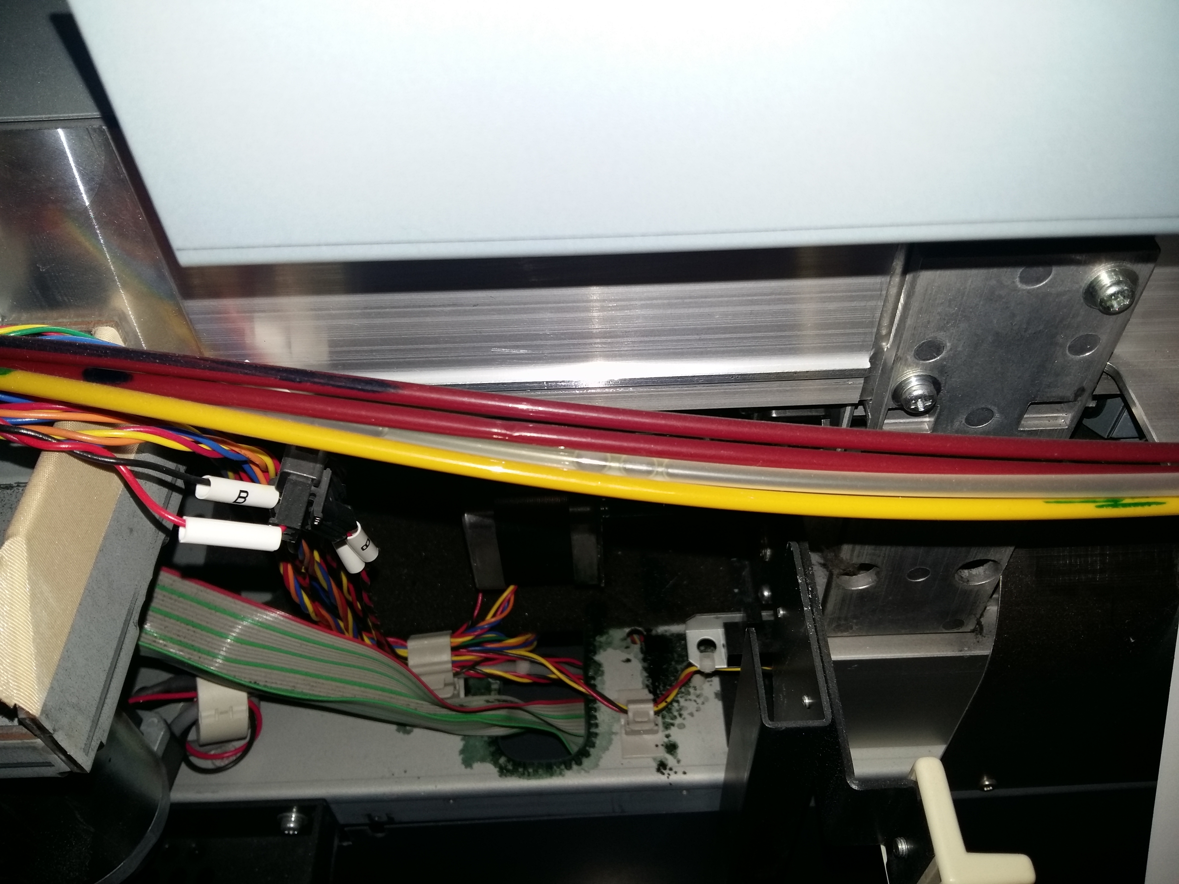

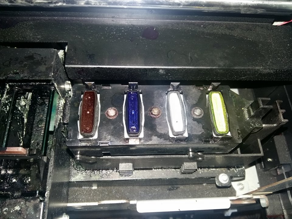

    I actually did as suggested and saw that one yellow line is empty and both cyan lines are empty....right now only black shows up on the test print..i did try to squeeze some cleaning fluid thru one yellow but it started flowing out at some connection point right on the center...i attached some pics...could it be that the o-rings on all connectors need to be replaced?

    Hi guys,

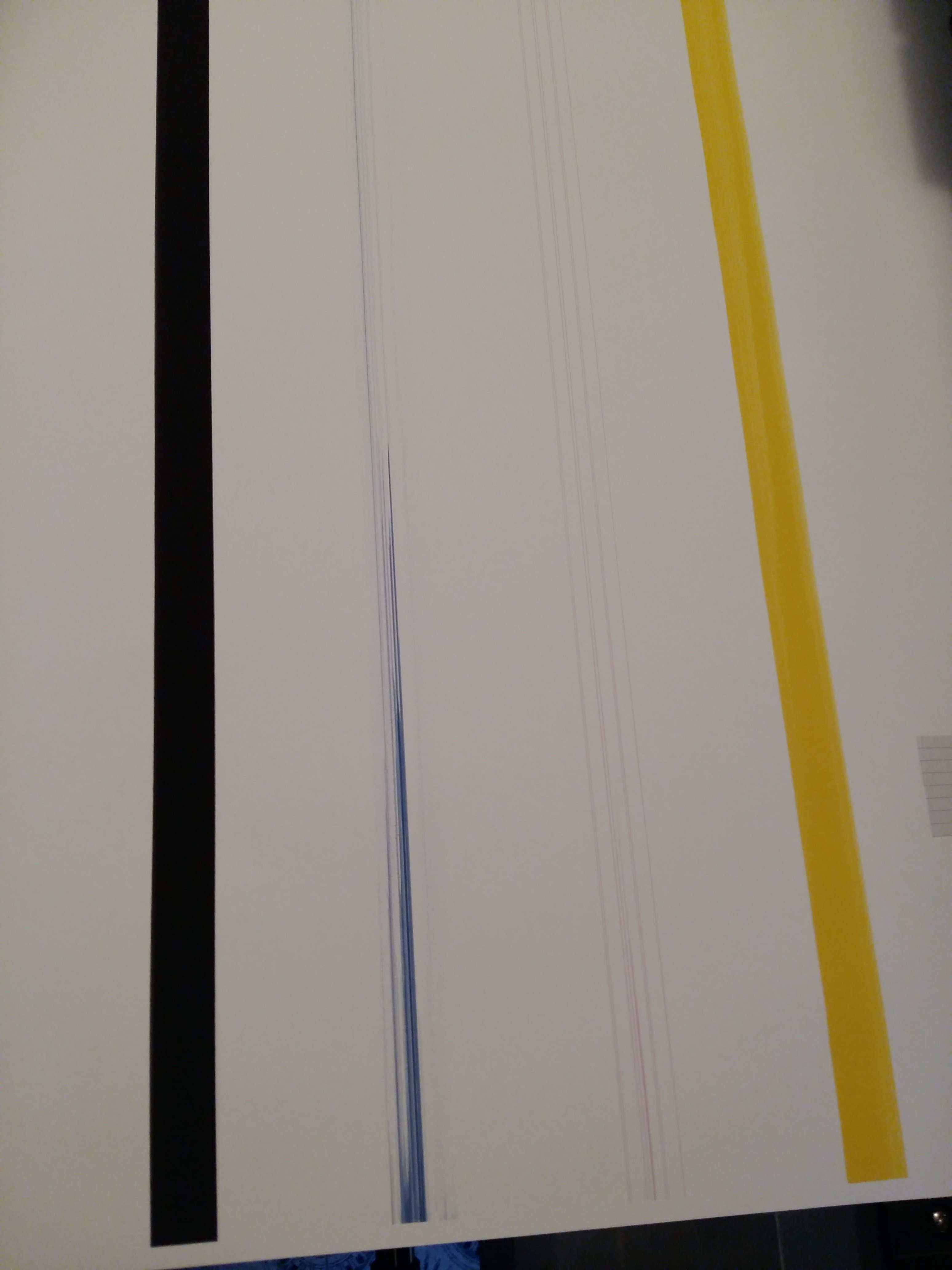

    if anyone has an idea what might be the problem id appreciate any comment...i changed the dampers and the ink caps...ink fill didnt work for magenta so i filled it manually with a syringe and it worked...now kcy are firing but magenta is not..i attached some pics...i did a nozzle wash and noticed the cleaning fluid wont stay on the ink caps on the magenta cap...all other stay but magenta just drains immediately...after letting it sit overnight there wasnt a single drop of magenta on the new cap...one line of magenta is full but the other went back one 1/3 of the ink lines...any ideas on what to try? can the head be manually flushed on a jv22? like aking the dampers off and attach syringe with cleaning fluid insted of the damper and just try to flush or shall i try something else first?

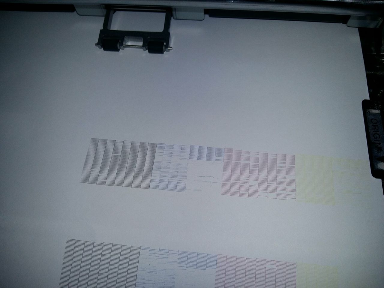

    Hello...after numerous nozzle washes...hard cleanings..ink fills i got at least a sign of magenta...one line is still not filling up and the cleaning fluid still drains on the magenta ink cap...here are aome pics of the test prints..is there still hope? 20180315_163250.jpg 20180315_163250.jpg

    You need to go back to basics and ensure the supply lines and cartridges are allowing the inks to flow freely when syringing
    inks through. Also recheck your dampers to ensure they have not blocked up. You then need to manually flush the heads to
    ensure all nozzles are clear. Syringe inks through the dampers so they are full and If everything is right,then do a cleaning
    cycle and a test print

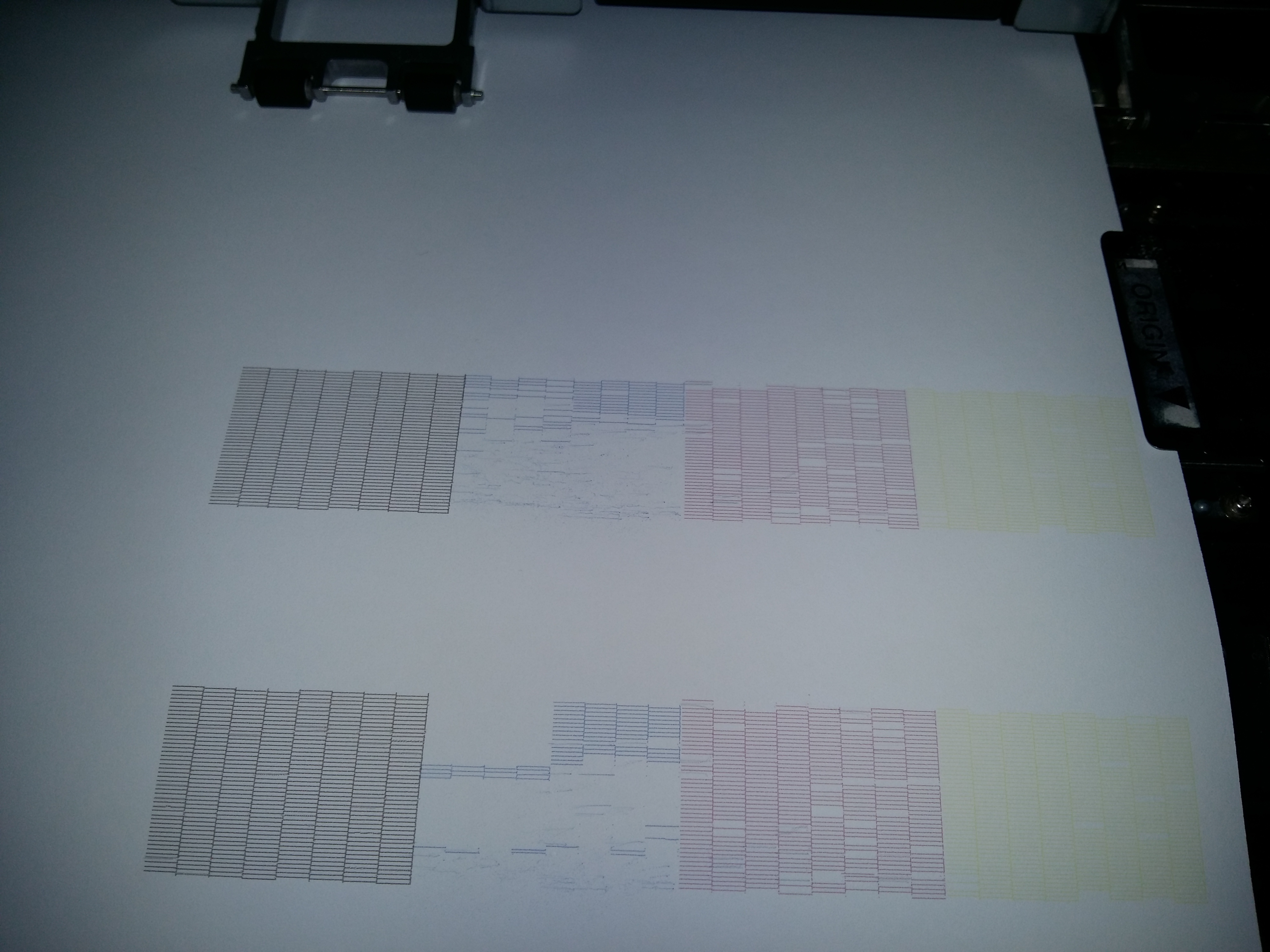

    Heres a latest nozzle check..should i just continue to do nozzle washes and hard cleans and hope the cyan will just likenthe magenta get better or will i only waste a ton of time and ink by doing so?

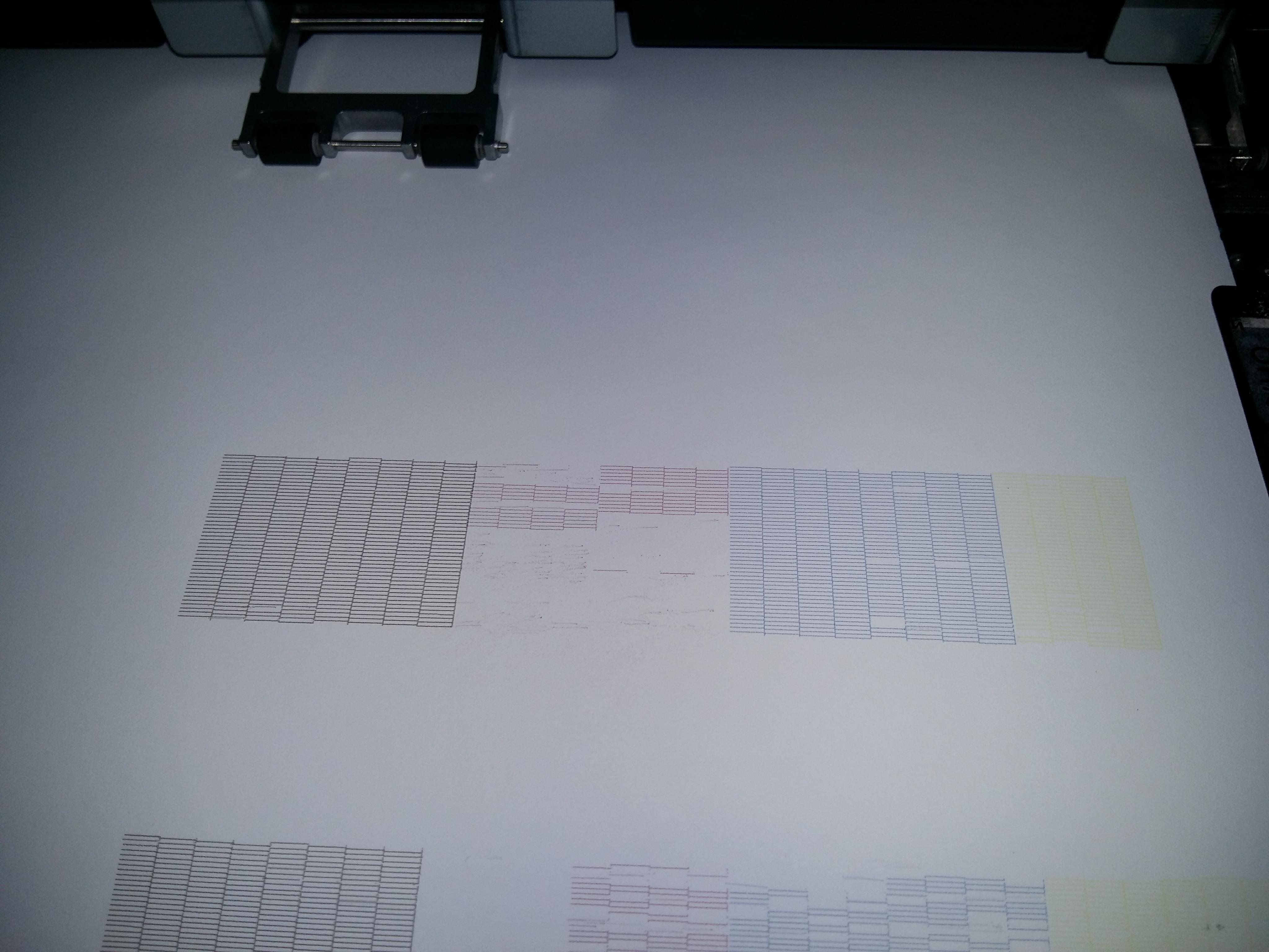

    im running out of options...after numerous nozzle washs and strong cleans didnt get the cyan nozzle check to improve i put the cyn dampers on the magenta head just to check if it not a damper or line poblem and i also switched cables with the magenta head...the result is attached and cyan came out ok...now my question is if that means the cyan head is dead or if there is anything else to try?

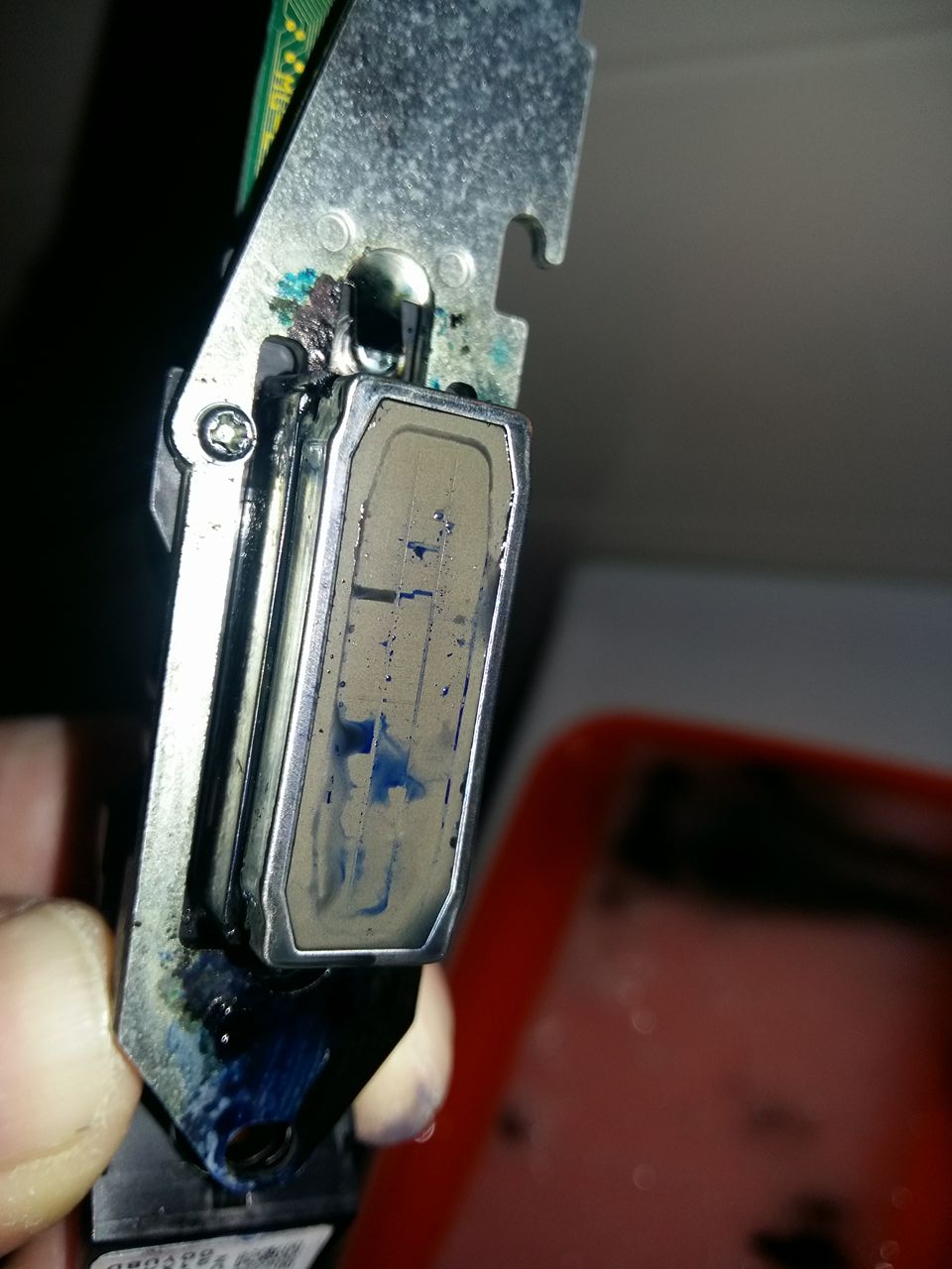

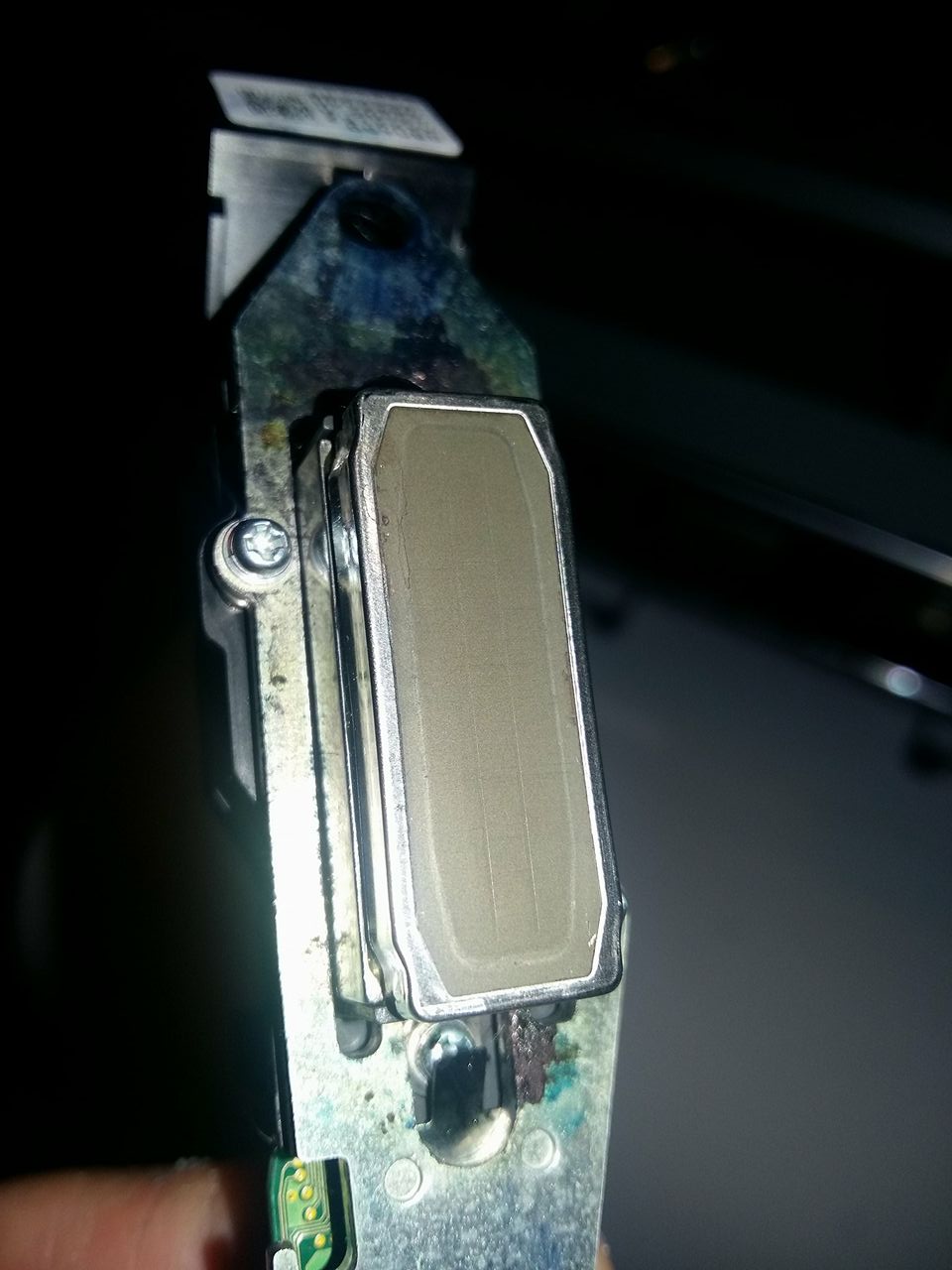

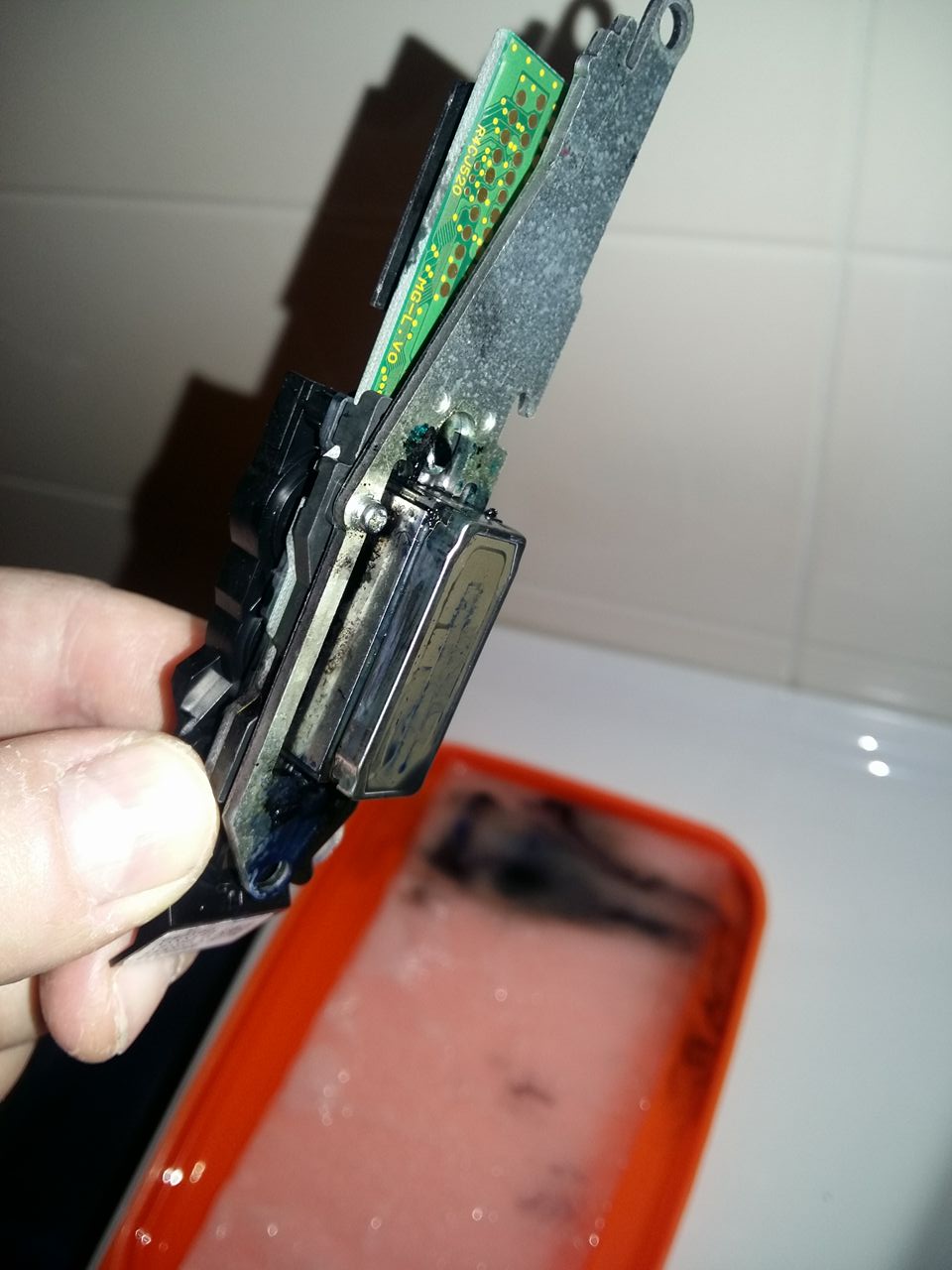

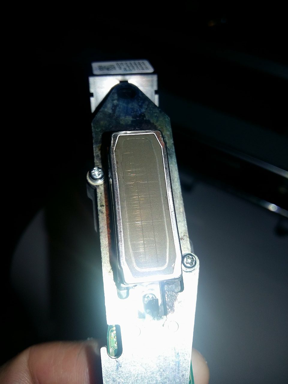

    i already did a manual flush before...today i decided to tske out the printhead and let it soak in distilled waster and isopropyl alcohol...here are some pics of the head i just took out...tomorrow i will flush the head with a syringe and some more pressure to see if i get a good stream snd will then put it back in...ill update u....thanks for the help.
  14. Bili
    Bili New Member
    17
    1
    Jan 10, 2018
    Zagreb
    After doing the soak and the flush the was a little improvement but not enough to work with it so i have to get a new head...i use the printer for dye sub so i guess im supposed to get a water based dx4 print head...but i have an offer for a much cheaper solvent dx4 printhead...we are talking about new printheads...will the solvent one work too or will i have to get the ater based one?
