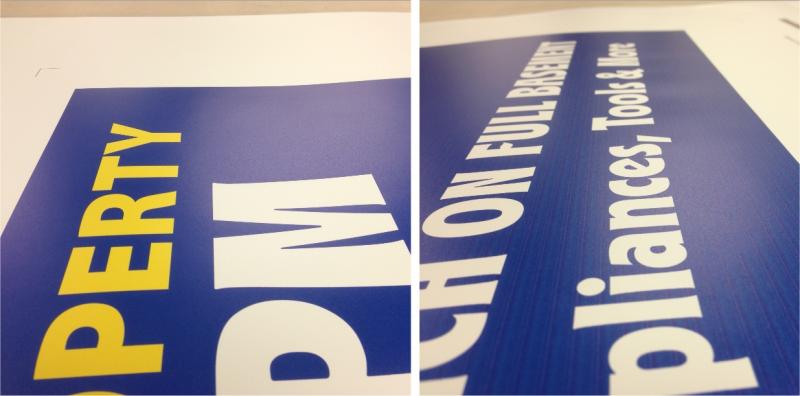

    Here is what I just printed. I am on 6 pass, 720X1080, and I gave it a .7 second delay between passes, and a refresh rate of 1 (although I'll admit I have zero clue what this setting does). You can see how perfect it is at the start, and how terrible it is by the end.
    I feel like I should be able to get as good of results as I had printing 4 pass on my JV3 for 5 years, and having way less banding than this. I guess I'm not against doing a two pass if I HAVE to, but seems like overkill for things that I'm not even trying to achieve awesome quality on, I just want what it starts out as.
    It doesn't matter if the heaters have been on, or if they're just warmed up and just started printing, always the same results on printing a solid color, or a solid photo. Never changes.
    Any tips that any of you see right out of the gate?

    It definitely ink starvation since it starts fine and loses quality as it progresses.
    You could try re-profiling with lower ink limits to reduce the amount of ink it's trying to suck through if damper replacement doesn't work.
    Also try upping the refresh rate to a higher number. Based on this thread, it would appear the consensus is that the refresh rate is how often the print head will pause mid print to refill the dampers.
