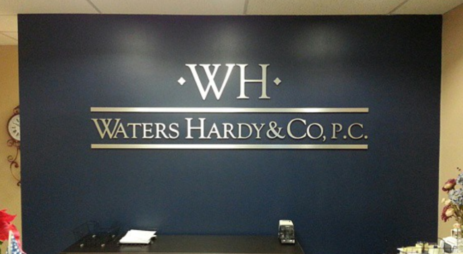

Do you have any long, narrow pieces in the project? Like rule lines or underscores, like these?:
If so, you may want to use solid aluminum for those pieces as they tend to warp if laminated.
