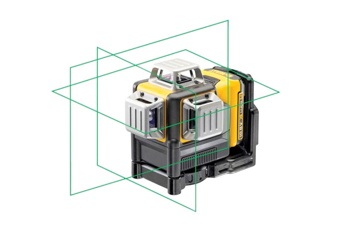

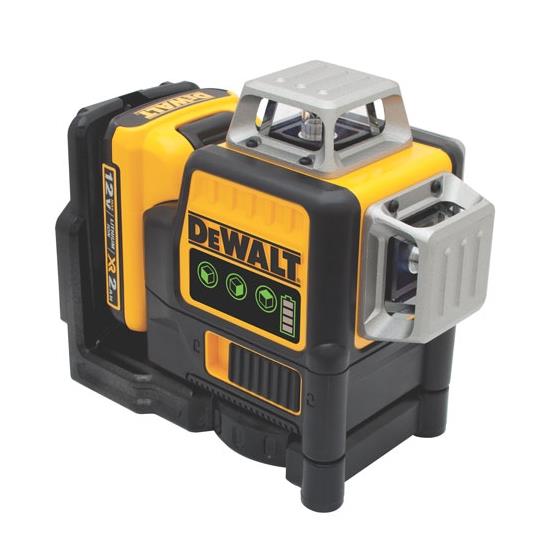

Definitely go green, you will be able to see it from a further distance. Warning, green lasers eat batteries like crazy. I loved my bosch but I bought so many AA batteries that I decided to get a Dewalt 12v crossline with a plumb dots. In hindsight, I should have bought the Dewalt in the first place.
I have worked with one of Dewalt's 360-degree green laser and didn't like it. It's the one that has a thimble size reflector balanced on a pin. We were working on the 6th floor of an office building and anytime someone walked within 20 feet of it, the line would start bouncing...
Here is an Amazon link for the one I picked up. https://smile.amazon.com/gp/product/B011HX4GPI/ref=ppx_yo_dt_b_asin_title_o03_s00?ie=UTF8&psc=1
It is helpful to have an extra battery. The batteries are expensive but you have a couple of choices; buy a twelve-volt tool for $99 and get 2 batteries or I found a deal on Amazon for two 3Ah batteries https://smile.amazon.com/gp/product/B07WRDX8CM/ref=ppx_yo_dt_b_asin_title_o01_s00?ie=UTF8&psc=1
