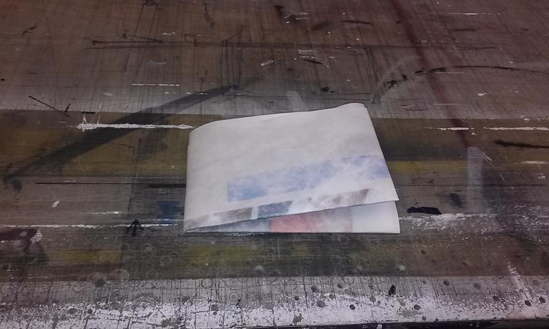

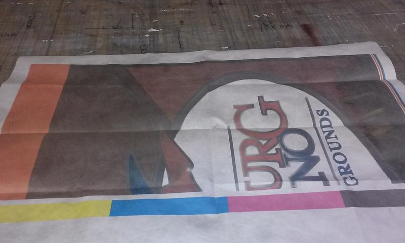

here is a sample I printed (l25500) years ago trying to use tyvek for a roll to roll sign at a ball park.
folds nicely too.
