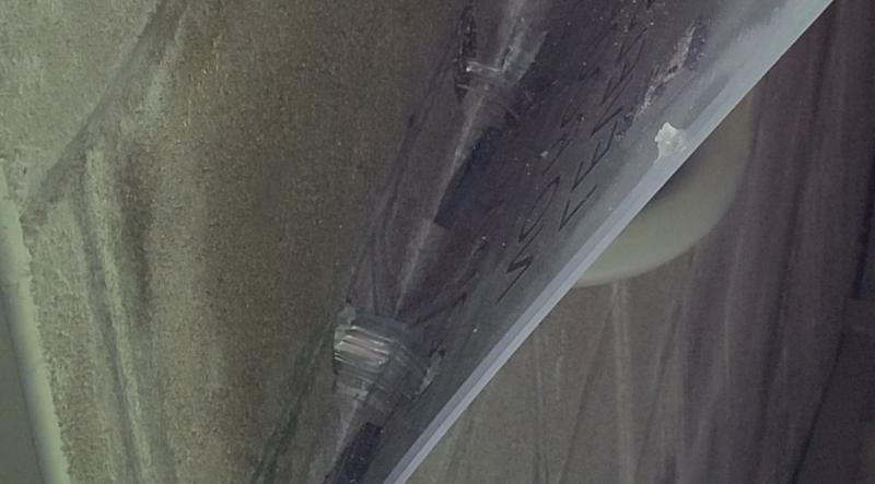

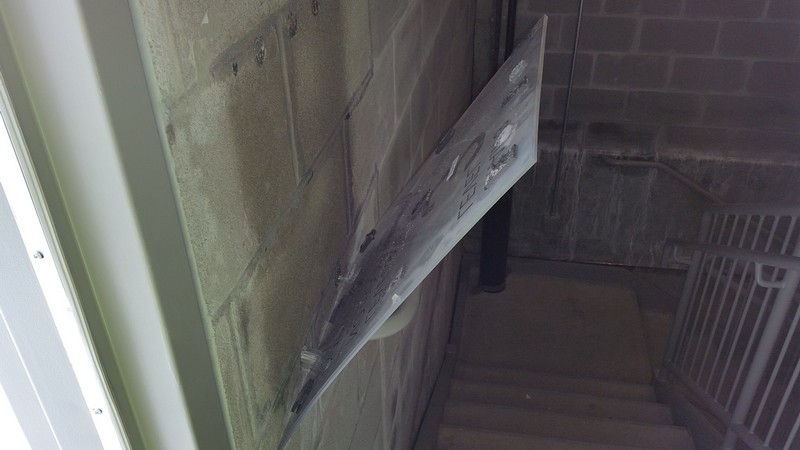

This was an acrylic sign that was damaged in shipping. Installed on a concrete wall til the replacement came. The picture is after removing all of the tape and silicone except for the bottom. Silicone would never adhere this well. The sign is 19" x 16", double-layered, so about 4.5 lbs.
The weight of the sign didn't stretch the Lexel - it didn't stretch until I physically pulled the top of the sign outward to where you see it in the picture. After the photo, I pulled it outward a few more inches and it hung there for a bit and finally the Lexel broke where it was stretching.
Anyway, this is why the stuff is recommended so highly for acrylic and polycarbonate.
