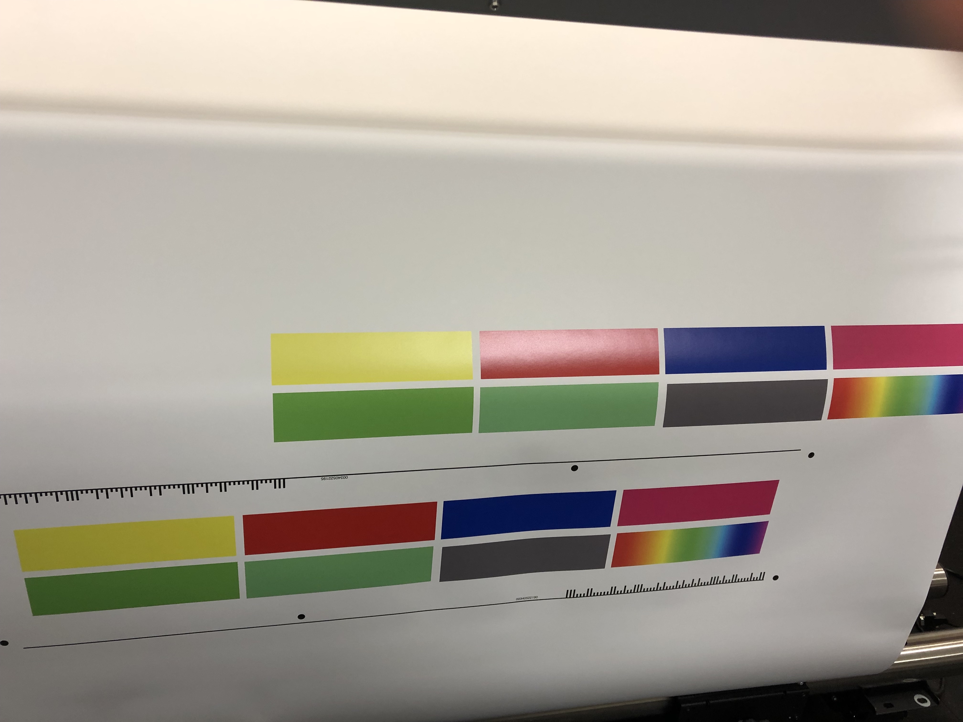

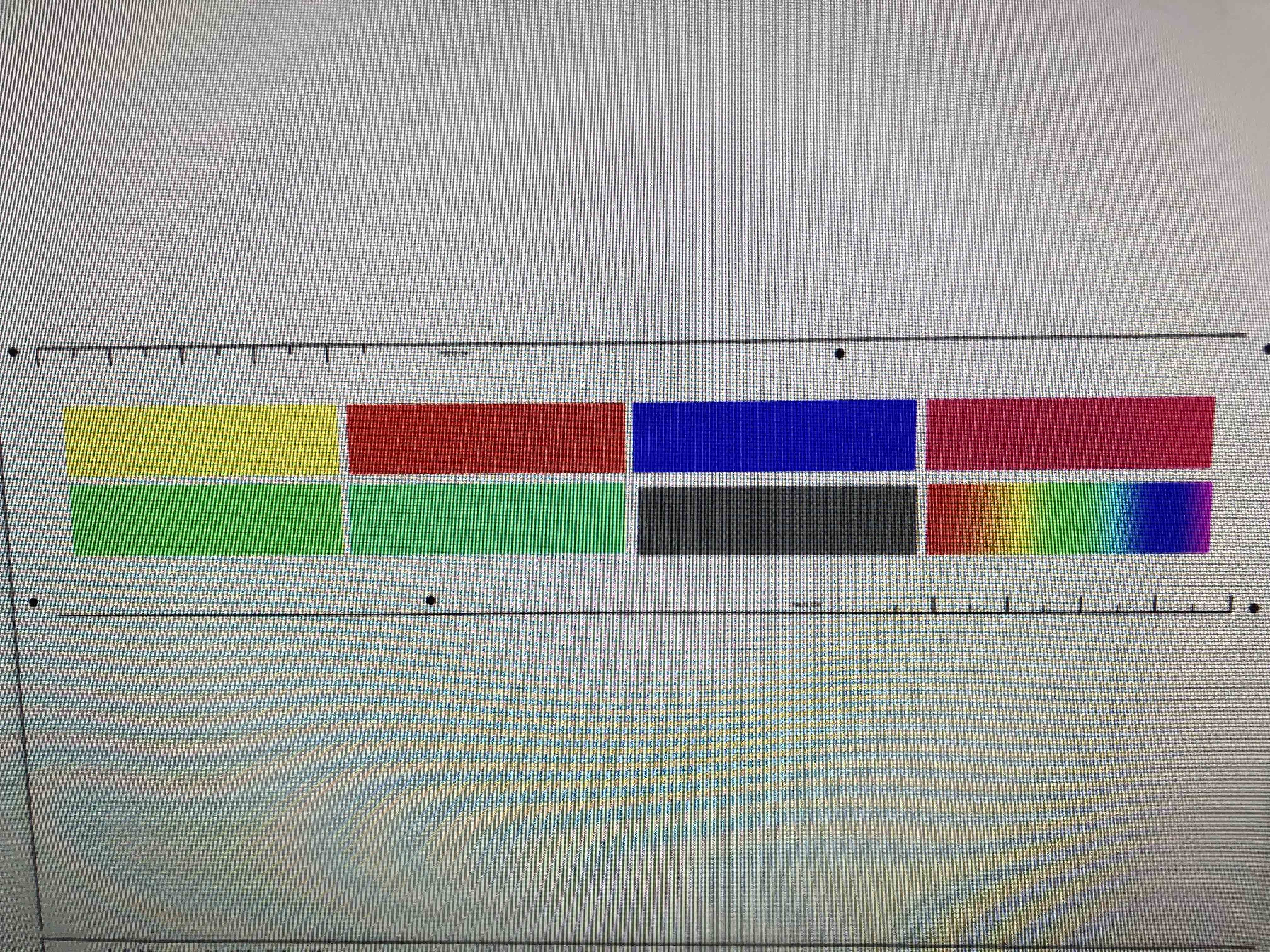

    Yeah here is an example of same file and everything out of 12 crop marks and barcode show and print. Flexi 19 cropmarks show and don't print. I think this was partially a flexi driver issue but who knows. Their office has a valuejet and hp latex machines to replicate problems so make sure to let them know. Hopefully they get it fixed but this was the line in the sand here. There are other problems but we didn't even try to test everything we emailed them, got the link I posted and went on our way back to 12 after a half day wasted thinking maybe it was us.
