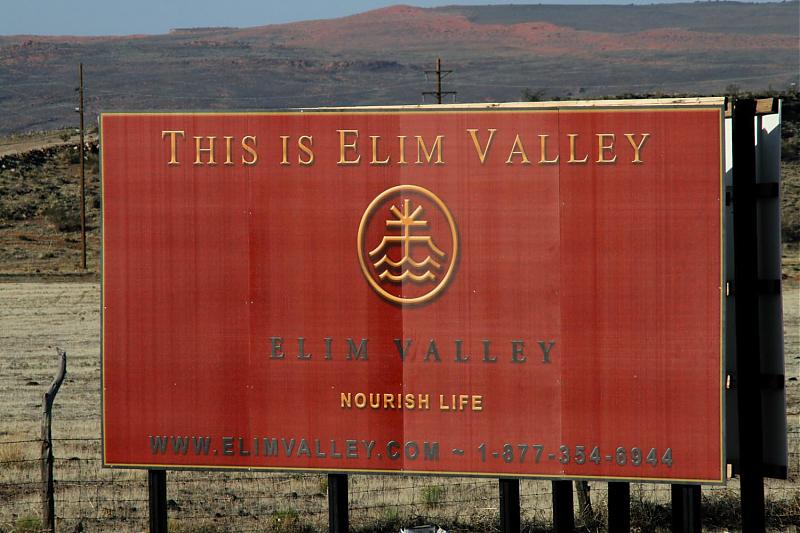

    We run 98% of our stuff uni-directional with one lamp as the bi-directional pattern is unnacceptable. We're having the tech come in because we have strange anomalies, where even running uni we hve inconsistent patterns. We even had a couple 8x16 MDO jobs that were rejected. They looked great in the shop, but out in the light was another issue.
    Check out this pic, this job was run in production, uni-directional.

    Yeah, that is nooo good at all and you should NOT be having those issues at all. Our worst bi-directional does not look even like that. You should easily be able to run bi-directional with both lamps (what they recommend) and have really good looking prints. We only run the one lamp when we have to or have darker prints. If you threw a matte lam on that though it would definitely have helped big time, just as a heads up.
    I'm sure you guys are going to but do not let them leave or give you any run around without that being fixed because even our billboard mode doesn't look like that.
