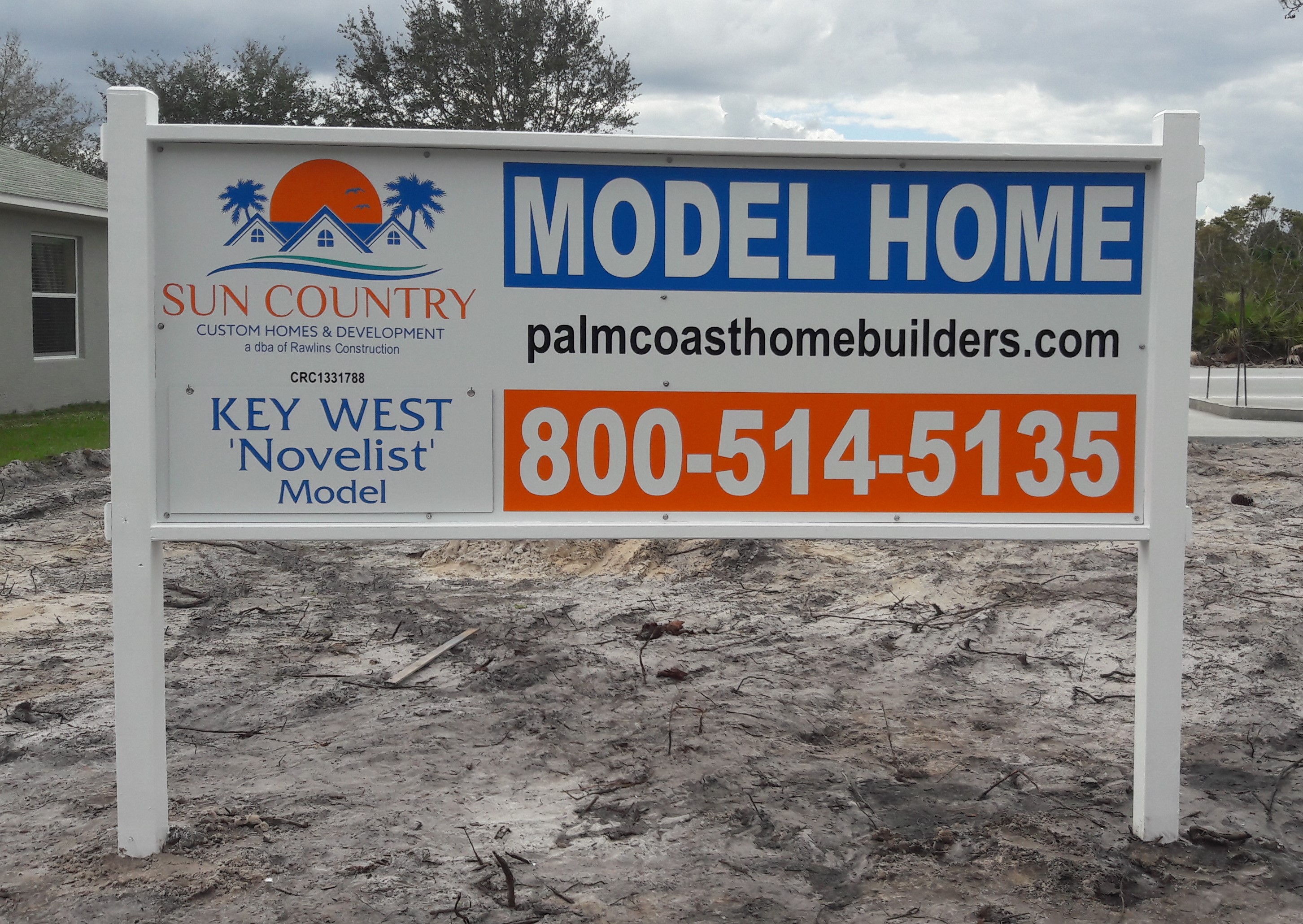

Looking for critiques of this sign frame
The layout of this sign isn't what we wanted, but the regulations gave us 24 sq. ft. and a max height of 5' so options were rather limited. On a budget of course, so no fancy post covers, just painted wood. Just wanting some honest feedback on how 'professional' it looks for a painted wood frame. Thanks all.

For what the sign's purpose is it looks fine to me. I'd paint the screw heads white so they don't stand out so much. I usually use small painted white washers behind those hex screws to give them more grab.. but we have some windy conditions here in North Texas so it may be overkill for your area.

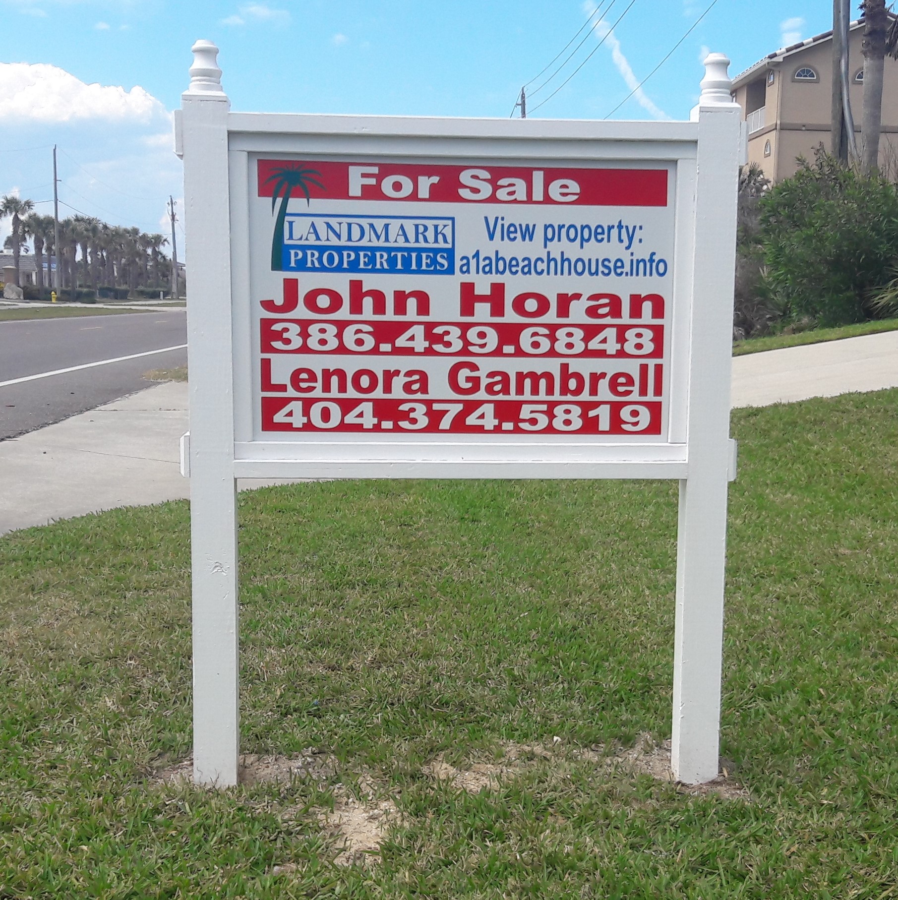

Yeah, I usually have white screws on hand, but unfortunately didn't for this one. I don't think the ACM needs the washers, but time will tell. Here's another small sign I did without screws. The sign is f'in ugly, but the frame looks good imho. (Other than that gap between the 2x2s)

I've only been doing it for 39 years but I'll give it a try...
-- Wassup with the chunks of wood slapped on the sides... looks like an after thought...
-- The finials on the one don't seem substantial enough.
-- YIKES, Paint the attachments or, learn to build a sign where the attachments are hidden
-- On the layout... dude! stop abusing type - you squeezed and stretched it to death
-- The layouts have no rhythm.
-- Learn to K ER N
-- You can do without some information.
-- I googled the companies logo - I'm guessing you didn't find vinyl to match - not that it would have helped, the colors are really bad on the original.
-- Try staying away from primary colors... the reds and blues are too much for a sales sign.
-- Why white background? - I'm thinking you only do cut vinyl but you can layer it or paint the background.
-- Google "MODEL HOME SIGNS" and notice the use of color on most of the nice ones.

Thanks for the input on the Frame. The side caps were an afterthought of sorts. needed a way to access the lag bolts for when the sign gets disassembled and moved. As for colors not matching the logos, they are way closer than they appear. Funny how a cell phone pic in poor lighting can look so different than the actual colors, and also amazing how cut vinyl never seems to be available in web page colors. As for the layout on the real estate sign, that was probably the 9th(and by far the worst) layout. All I kept hearing was I need my name bigger, is there any way we can make my name bigger... The red? believe me, not my choice at all, but I'm sure that in your 39 years you have had at least one RE agent that believes Red is THE color for 'maximum visibility'. I will have to agree I should have used white screws, but those heads were painted after the pic was taken. I usually use white screws with the white background, But if not, at least I use stainless and not just drywalls that rust like a lot of others do. As for the white background on the Model sign, customer was on a budget, so cut vinyl, and fewer colors to save them some bucks.

They look like a lot of work, measuring, cutting, painting and assembly went into them. They look fine to me, good job. I would have like to see the backs of them and framing.

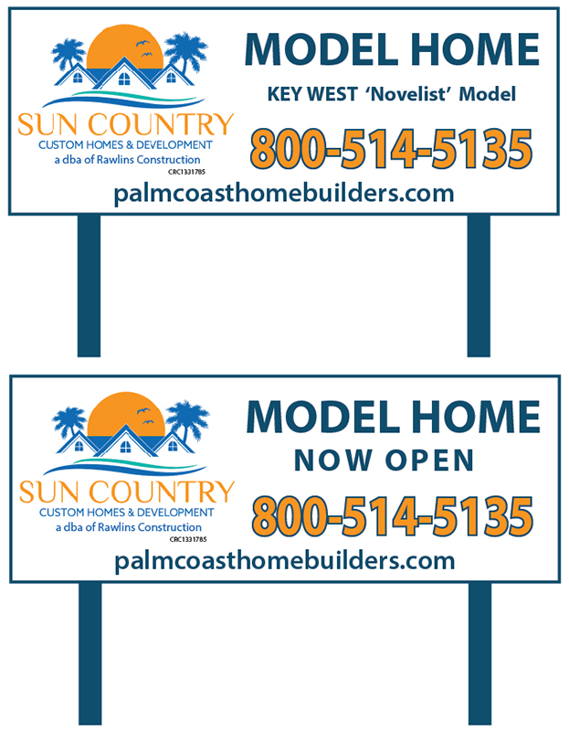

I tried this and came up with a different appraoch, but still using a white background. I think I would've put some color into the background.
I also don't understand the need for all that framework ?? I'd use 1/2" MDO and just rout the posts or use the end brackets. We just did some last week that way with the brackets. Painted them and you cannot tell a thing.
The copy and numbers are still large enough to see from at least 450' away. The logo is much larger and I didn't use so many colors. Personally, I don't like to see black copy on a sign, unless absolutely
The copy and numbers are still large enough to see from at least 450' away. The logo is much larger and I didn't use so many colors. Personally, I don't like to see black copy on a sign, unless absolutely View attachment 134477 necessary.
It's hard to tell from the pic, but the section with the model name is actually removable. it is on hooks and can be flipped over to say OPEN. It was a necessary part of the sign, otherwise regulations says they can put a 12x18 Model Open stake sign next to the large sign, which looks lame. So this is part of why the layout is done the way it is. The original idea had what was 2 4'x4' signs in a V, but not allowed by the city, so after a few go-arounds we got to this one. I do like the blue frame, but 3 of the 4 chiefs had specified they wanted white posts. You say you didn't use so many colors, but you actually did, lol. just different colors. As I said at the start, was on a budget, so... Anyways, I like your layout, and I wish I had the power to reject bad ideas from paying clients, lol. As for the framework, they originally wanted those plastic post covers, which are pricey, combined with what to do top and bottom to match. We used 1/8" acm for this job to keep costs down. As I said before, budget.

The backside would show the 2x2s that are flush with the rear edge of the 4x4s and the 2x4s. There is one vertical 2x2 brace centered, then one horizontal one behind the top of the Key West section for the hooks to attach to. That section can be flipped over to say OPEN.

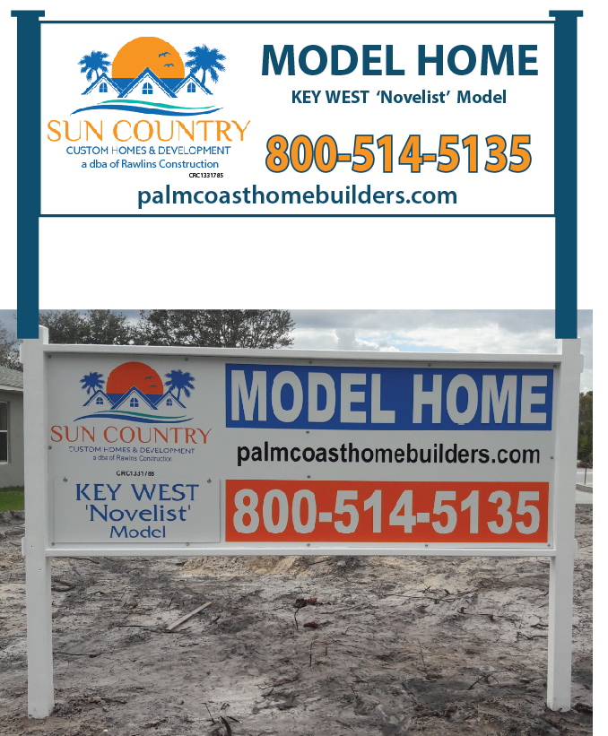

I used the same yellow out of the logo and the same blue, just darkened, so I'm not introducing more colors. I didn't realize this was a single-sided sign. Rather than all that framework, couldn't you have just screwed a piece of 1/2 plywood to two post and fasten the 3mm ACM to it ?? The 'OPEN' part is an easy fix.

They wanted something with a somewhat fancy frame but on the cheap, lol. I put in way too much labor making the frame, but it was enjoyable compared to just popping 2 sticks in the ground. One of my earlier layouts had the Model Home in just text, but they wanted more pop. Like I said before, 4 chiefs, so gets hard to please them all. I really wish we could have done the V, or at least the 2 4'x4' sections side by side with the appearance of 2 separate signs. It looked pretty sweet. But regulations is regulations.
