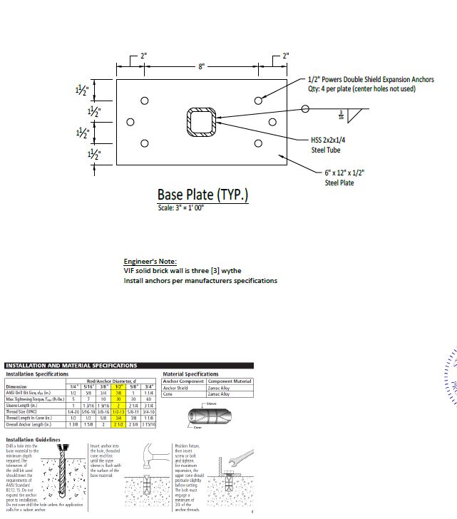

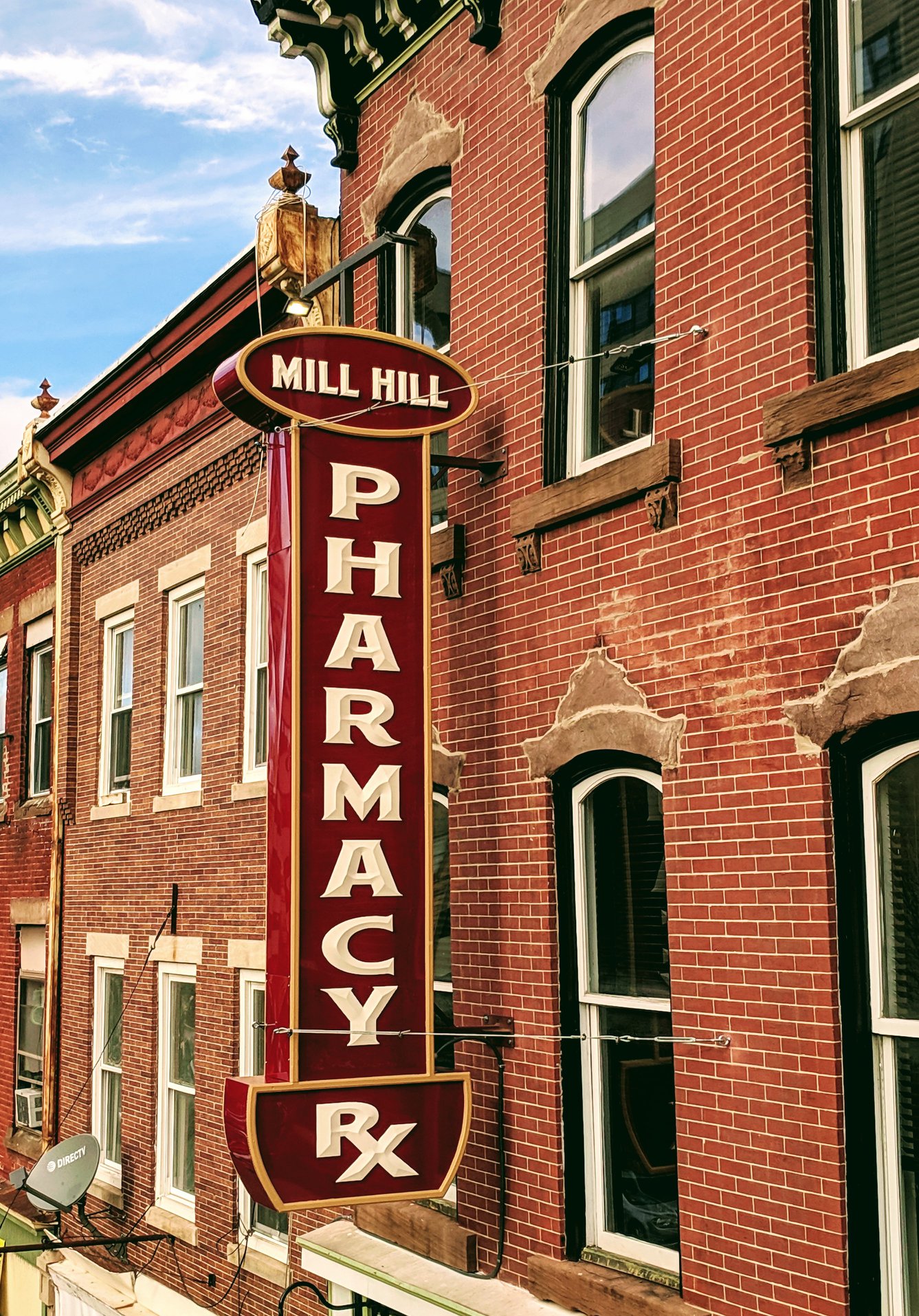

    anchor.JPG anchor.JPG Here is a blade sign we just did.Through the wall bolt mount is always the best way but we could not on this one.This is what a structural engineer spec'd out... with out the guy wires.
