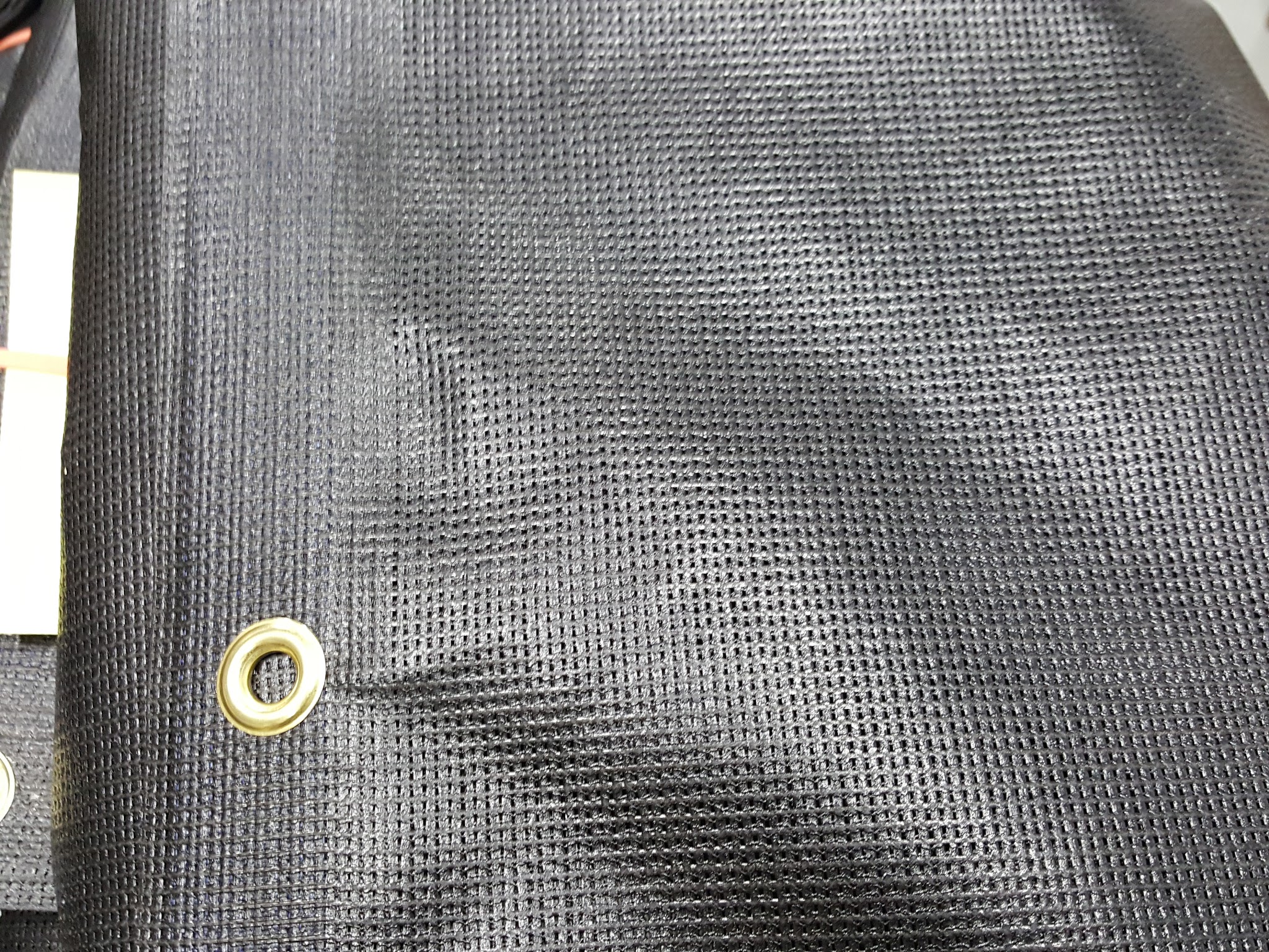

I have a customer who purchased a black PVC Mesh material to go on a fence around a ball park.
The customer wants me to attach some large decals of the local baseball team to the mesh.
I have an HP Latex 365 to print with but I am not sure what vinyl material will adhere really well to the mesh.

would vinyl not be defeating the purpose of using the mesh?also not sure how good your adhesion would be on that with any vinyl especially since you will have adhesive exposed thru to the other side. may be fighting an uphill battle on this one.
flyplainsdrifta
hmm. the only thing i can say for sure is you'll have a bit of testing to do. id start with the highest tack vinyl you got and go from there. how long are these expected to last for? I'm just unsure of the longevity of these, especially because quite a bit of the adhesive surface will be exposed in comparison to how much of the adhesive is actually stuck to the mesh. honestly i think you might have to play around to see if its even possible. other option is seeing if you can find someone to screen on the logo every x amount of feet to accommodate that part of the job. what is your timeline like on this job?
