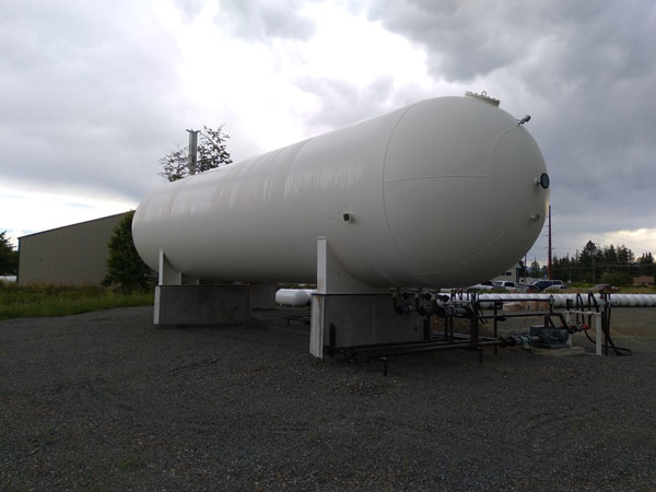

Giving this a bump since much of this information applies to a job I'm bidding on. Big propane tanks, 3 of them, lettering on both sides. Single color, so will use a premium cast cut vinyl. These tanks are brand new and have been primed, will be painted sometime in August, and ready to be lettered in early September. Daytime temps here still in the 60s then, but chilly at night plus the propane in the tanks chilling the surface. Has anyone else done tanks like this, and did you run into any unexpected challenges?
signheremd
Know this too well. Have found that Oracal 3751RA and 3951RA (both without ProSlide) work well - better than regular Avery Cast vinyl. Arlon will work if it is warm enough when applied, otherwise it will trap moisture and create water bubbles. Rollering edges is a big help. If the tank is wet or frosty, it is going to be a problem. Magnets help with positioning. Hope this helps
gnubler
It does. Good idea on the magnets. The vinyls you listed are print media, this job is all a single color red. I'd rather go with cut vinyl than printing it.
