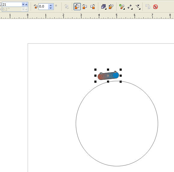

    Actually on another message board someone gave me the answer and it worked. I am still going to play with it tonight to perfect it.
    Here is what he offered:
    You draw one circle shape, make a duplicate and move it over. Then you have your path or shape you what to them to fit to, let’s say a larger circle.
    Use the blend tool to blend between the two circles. Select the Blend path tool and select the larger shape then adjust the two smaller ones to fit where you want them or add more to fill in as needed.

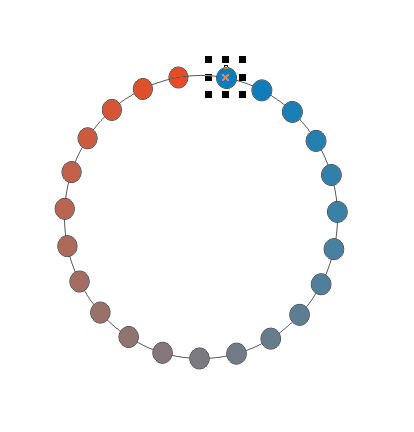

    Here are the other pictures he included.
    Then you can break the path and change them to solid colors.
