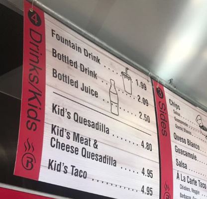

    This is what they currently have.

    What part of the sign is "curling"?
    That image shows a slight bowing, nothing I would deem out of the ordinary.
    Even the example Texas_SignmakerTexas_Signmaker of the 3MM ACM menu has what appears to be a bow in it, might be the lighting though.
    no fault of the maker, just what can be expected unless you get at least .25" thick

    I think your supplier is wrong..... very wrong. If this is anywhere near where the cooking or warmers are..... anything plastic is gonna warp, bend, bow curl, whatever ya wanna call it. I don't know what "infiniti" is, but if you're gonna hang it from that pipe again, you should be using something fairly lightweight, but yet heat resistant. Besides, styrene yellows out in less than 6 months inside.
    Be careful.
