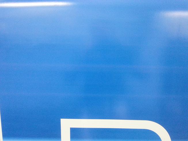

    Im getting banding as if printing lighter every 100mm and then back to normal as seen in the picture.
    Is there any thing i can do to stop this?
    Thanks

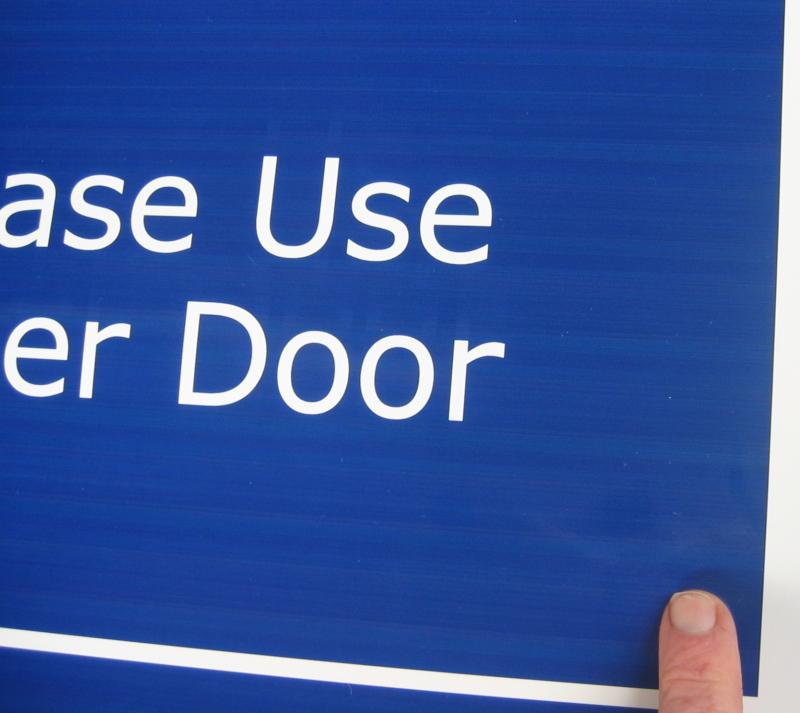

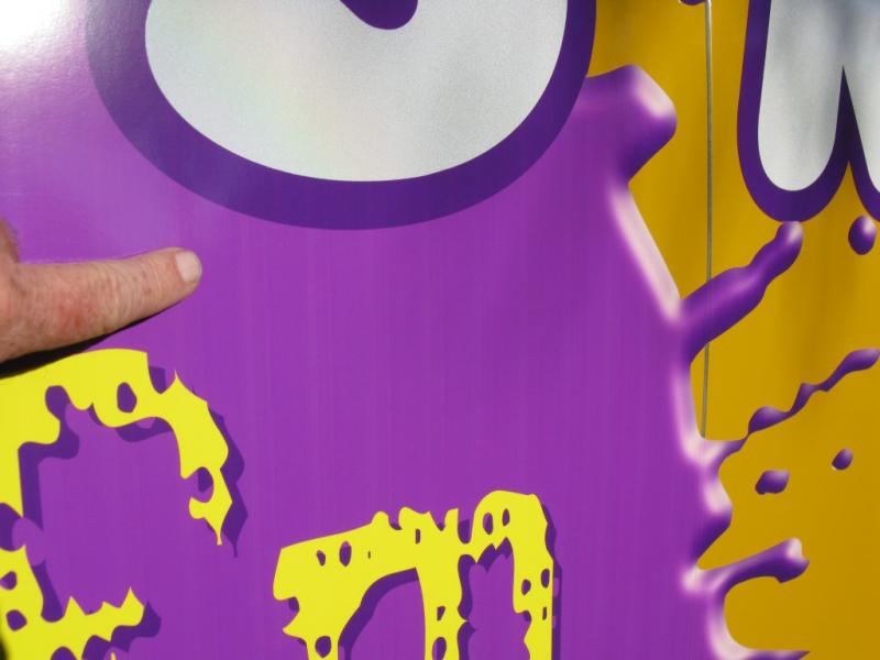

    I get similar problem with my CJV when printing some blues and purples.
    See attached. Haven't found a solution yet - not that I've tried much.
    It's only with certain colour shades.
    Changed passes, speed, temps, converted from vector to bitmap...still does it.
    If you're under warranty, try to get an answer from Mimaki...
