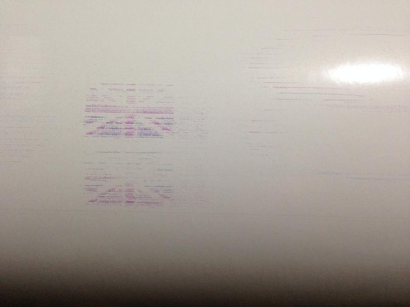

    I bought a Mimaki CJV30-60 used.
    But it prints using Illustrator CS3 with Rasterlink 5SG.
    The print will have a failure, as in the photo.
    Was made several cleanings
    Anybody know what could be the problem?
    [​IMG]

    It appears to me that you head is blocked, do a nozzle soak overnight (turn off the power at the switch after you have set a time)
    function , maintenence, carriage,down button then look for nozzle wash, follow prompts on screen.
