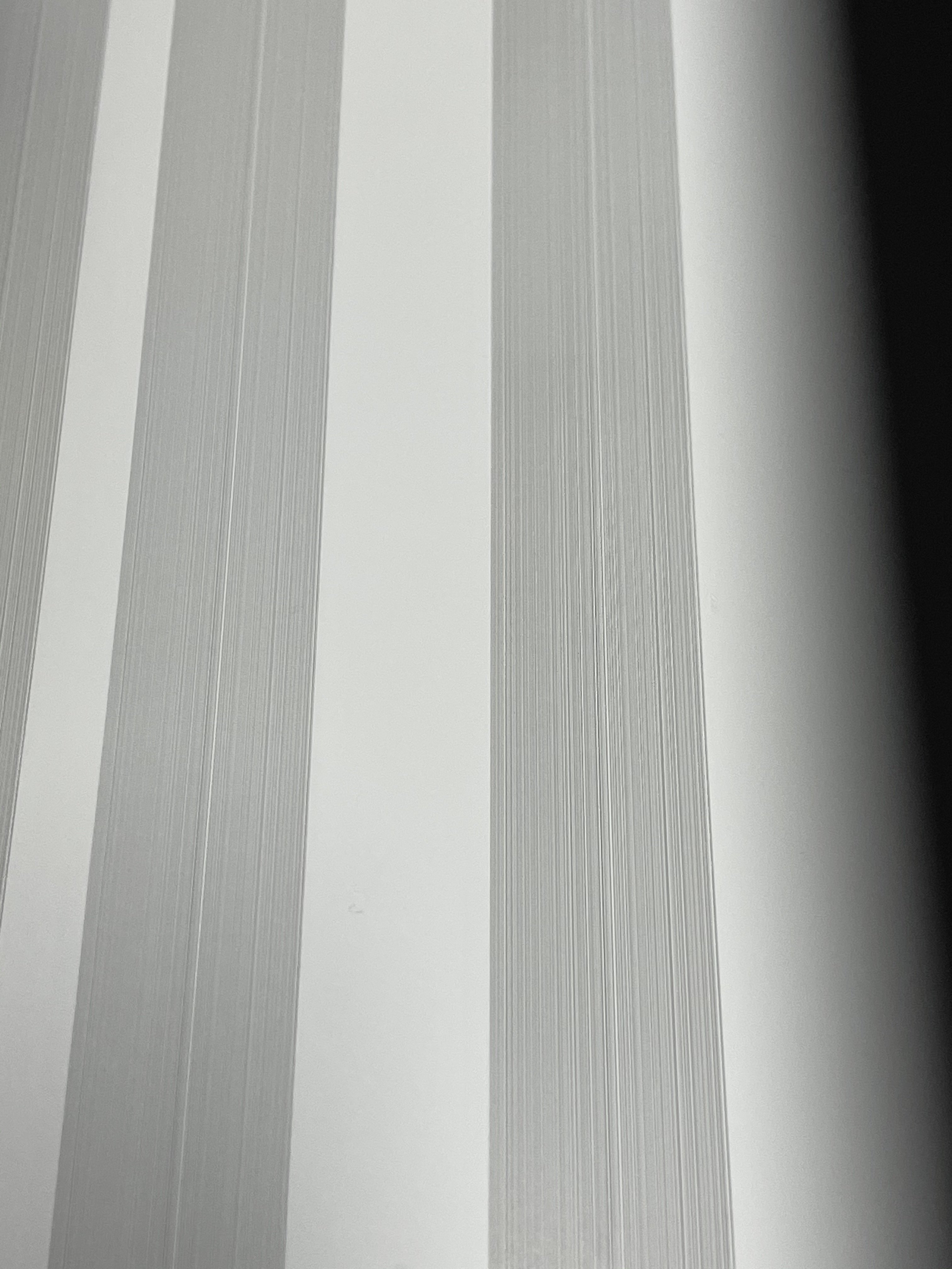

Hi I'm having horizontal banding issues, and I thought that doing a media compensation adjustment would fix the problem, but I found out another issue: the black lines printed to do the adjustment are coming with a weird banding. Does anyone have any ideas how to fix that?
I attached a picture so you can have a better idea of what im talking about. I did some nozzle cleans and the print test comes ok.
gabagoo
Run the printer slower and unidirectional and see if the banding improves...I guess you could lower the head also if it already isn't.
