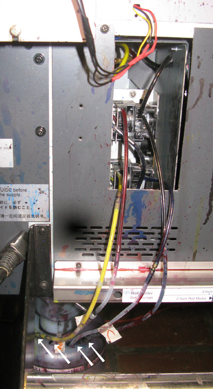

    i'd try this first. i don't have any trouble with my pumps if maintained.
    the best thing about it is i can have a partner dump solvent down the cap while i pull aggressively at the waste end. also if curious, you can pull a single line from the bottle to see if you are getting flow. and when you get a little vapor lock in a head, it's very easy to just pull a light vacuum at the waste line to get rid of it. not to mention i never ever do "ink fill". just pull at the damper then pull at the waste line. no wasting ink.
    i just bough another meter of tube because i'm going to run my waste bottle to the front of the pritner (mount it on the wheel base). there's really no reason that i should need to go to the back of the printer if i can have it up front.

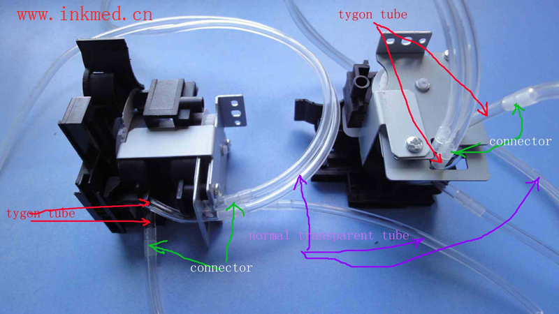

    The very important part of the pump is inner tube.
    Many jv3 pump not work well because the inner tube not soft enough like the tygon tube. Please check the picture in attachement.
    When the inner tube is original tygon, it will work well.
    Adam from Inkmed
