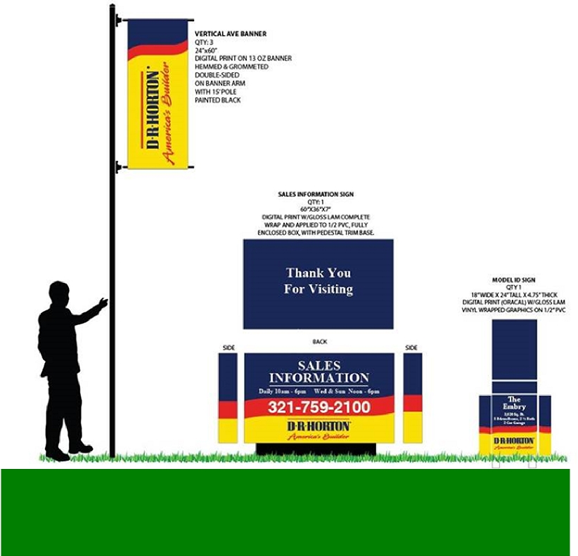

  1. My biggest customer, DR Horton Homes, has come up with a new style of sign for their Sales Centers. It is basically a mini monument sign made from 1/2" PVC. 60"*36"*7" is the size.
    I am working on the pricing and it seems crazy to me. I have $654 in costs before I do anything. No cutting, no mounting, no assembly. Their old Sales Center welcome signs were just simple 48*36 2-sided signs on white painted posts which I sold for less than my costs on this new design.
    What do you guys think this should sell for?

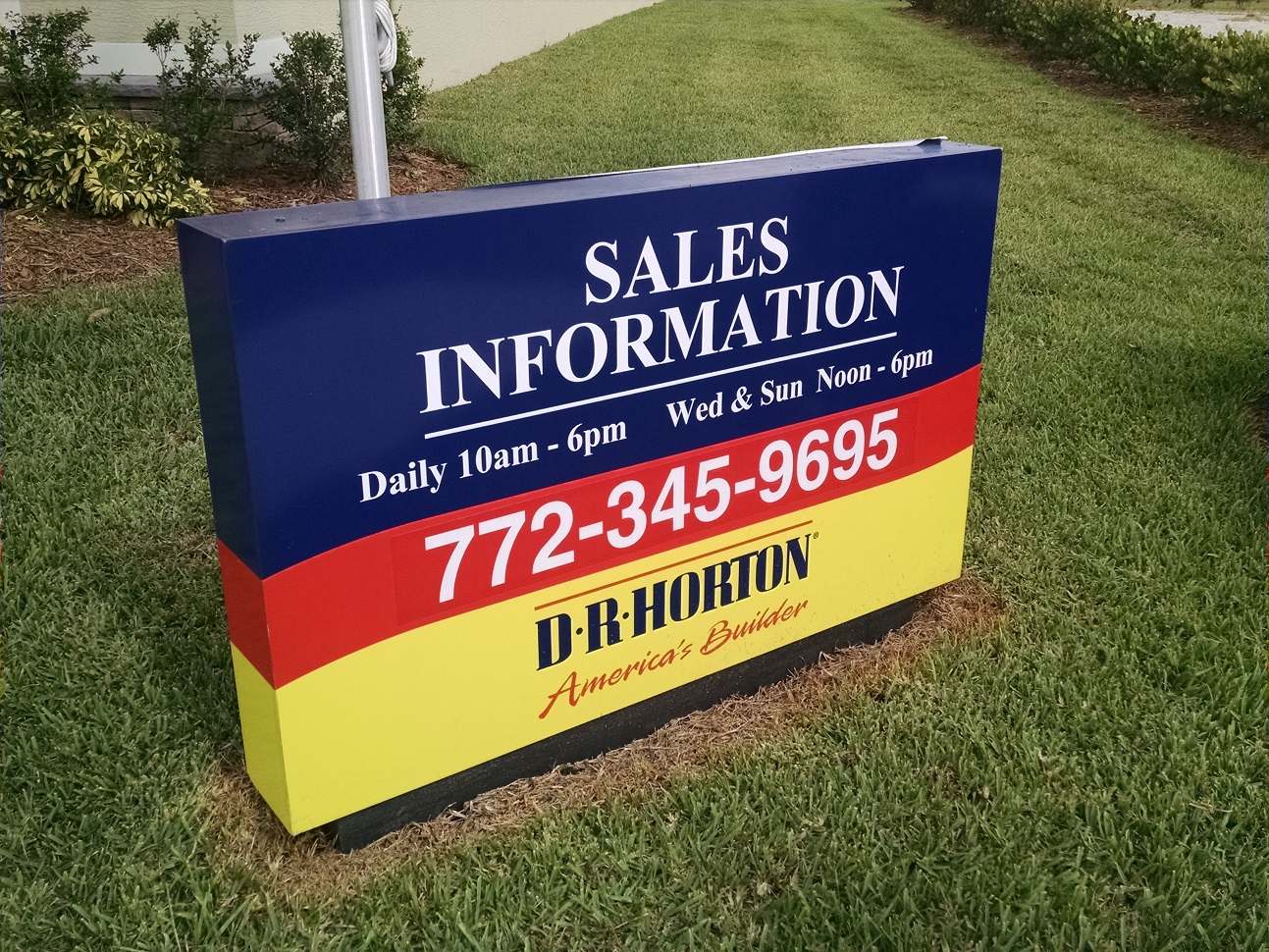

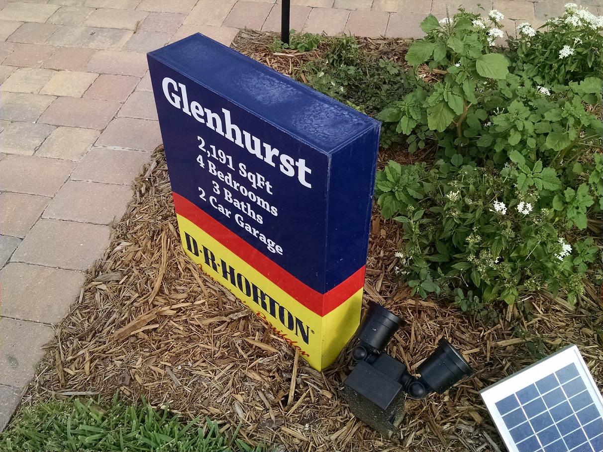

  2. Here are some pics of the actual signs in the field (made by another sign company)

    For the cost of the pvc, your printing cast with laminate, base that $654 sounds about right, your still going to have labor cost for fabrication and installation, so ballpark at doubling your cost $1308 and then the rest, would be $3500 to $5,000 range.

    Well, whoever made those other two samples did a lousy job. Is that how it landed in your lap ??
    We've done a bunch of those kinda signs over the years with all kindsa decorated faces, but never did we use a laminated digital print. We've always used clear acrylic, sprayed them and used vinyl lettering on them. I have some out after 20 years, still looking good. Your digital print idea won't last even 5 years if you're lucky, especially where you're from.

    Why PVC? I would build a frame from PT and skin it with ACM, looks the same for less cost and no PVC edges to deal with.
  10. PVC is what they specified. What is ACM? Not familiar with that term.
  11. Oh - ACM is aluminum composite bond. Heard it called dibond but never ACM. Duh... Thought about doing it that way already and will probably present it as an option..

    I can understand that low cost, just by looking at the quality those others had in them. Without degrading your competition, you need to ask them if that's the quality they desire or something made worth professional craftsmanship ??

    I would avoid PVC for this completely. It will warp when used this way in Florida- unless you spring for marine grade, and then they're really not going to like your price. It warps here in Georgia, too, when people use it this way.
    ACM is probably your best bet- with the bonus that it'll be lightweight (at least half- or more- of what the PVC would weigh) when you go to install it.
