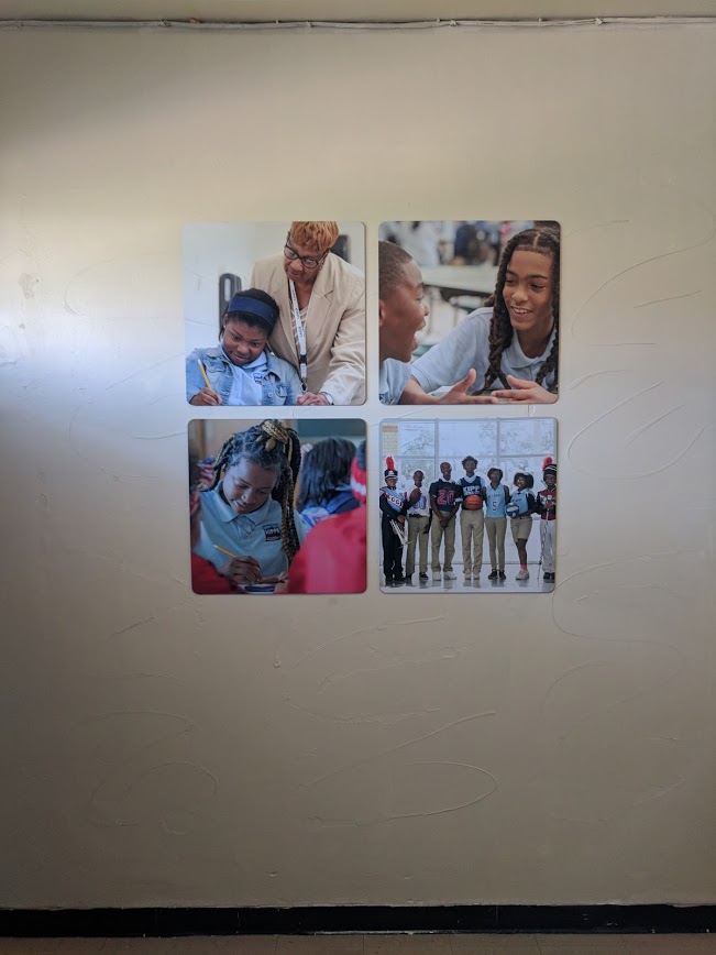

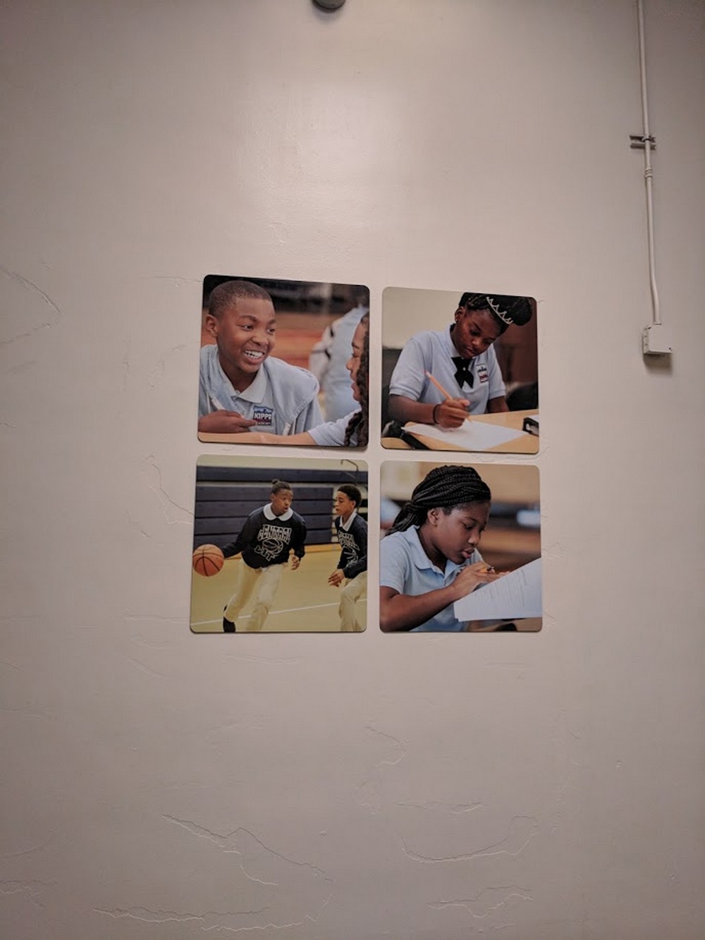

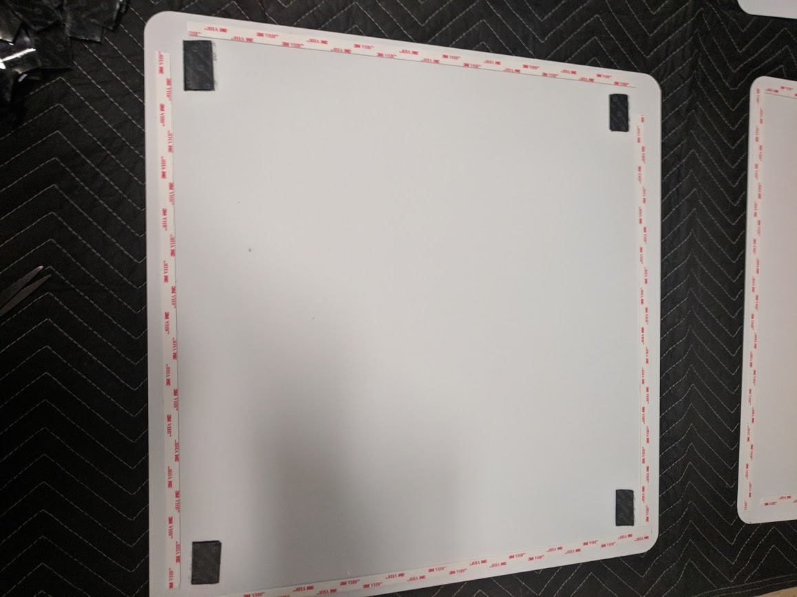

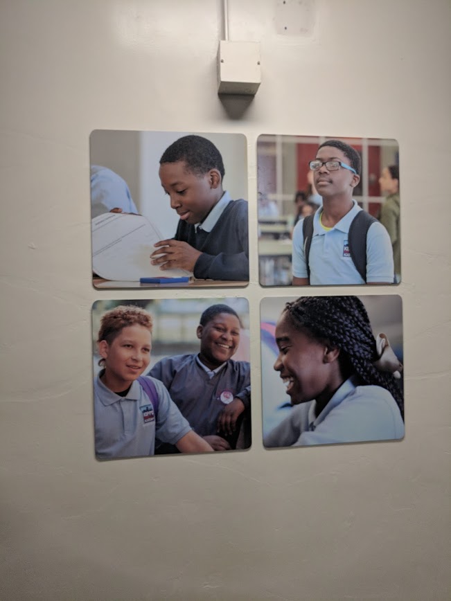

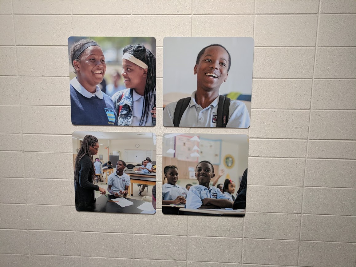

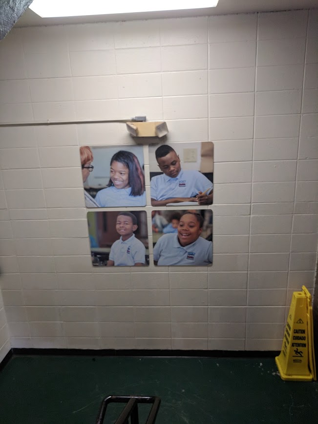

Update.
nolanola
Ah good, a Happy ending.
Tell us, how did you finally approach it ??

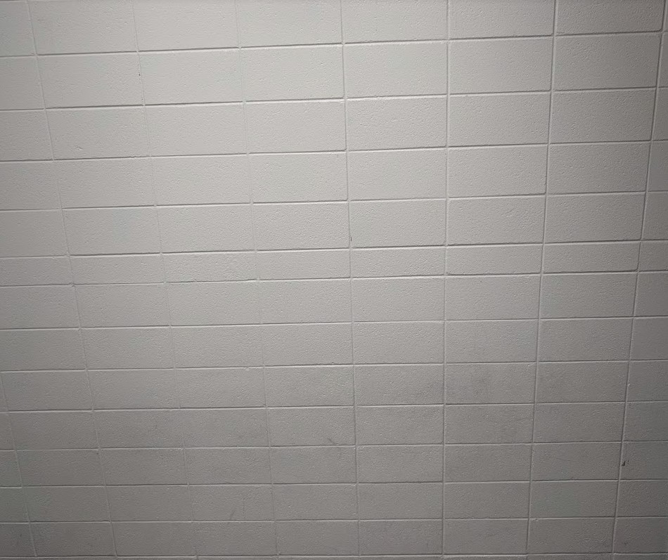

Velcro on the corners + Sikaflex (now I think it could be any silicone). Both from Home Depot.
Velcro has enough depth in it to compensate an uneven surface. And the sticky side of it is strong.
I even called 3M: they said none of the double-sided tapes they produce will work on a "bumpy" surfaces. A lady on the phone recommended adhesives 3M 2216 and 3M 1357. I will try them next time.
Thank you!
