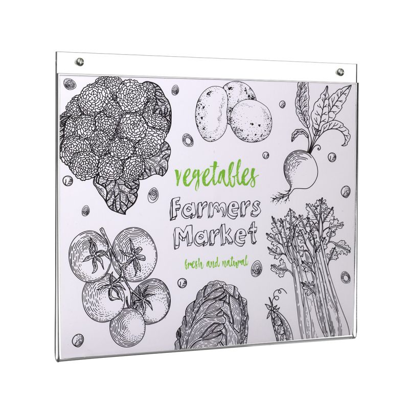

I have a client that wants several 4' x 6' sheets of ACM with acrylic sign holder frames (like the image below) mounted on them to use as an information board. They do not want the frames mounted with adhesive tape, the want them mounted with screws.
I'm thinking of using well nuts to give them the ability to remove frames if necessary. Once the sign board is complete they will mount it to the wall.
Is there anything better than well nuts to mount these frames with so they are removable?

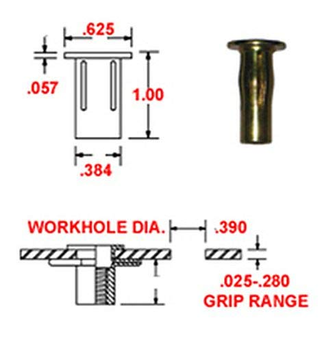

The screw post is a good idea otherwise Rivnuts would work, even if you had to put them backwards so the wall side would be flush.

I tried well nuts and they will not work, they fit and tighten just fine, but if you take the screw back out they expand back to their normal shape. My concern there is they could fall or be pulled out and lost, creating problems to reattach the holder.

I was suggesting Rivnuts, also referred to as Rivet Nuts, not Well Nuts, try looking at those.

Rivet Nuts would work great but the issue is the installation of the panel when you are finished. They stick out the back of the sign so they can't mount the panel flush to the wall. 3mm ACM is floppy, if its not mounted flush to the wall it will be wavy unless you make some furring strips or something. You could make the panel dimesional by turning them into shallow pans with 1" angle returns. They would be much stiffer and the could cleat mount them to the wall so you would have a very clean install and the ability to mechanically fasten anything you wanted to the face.
