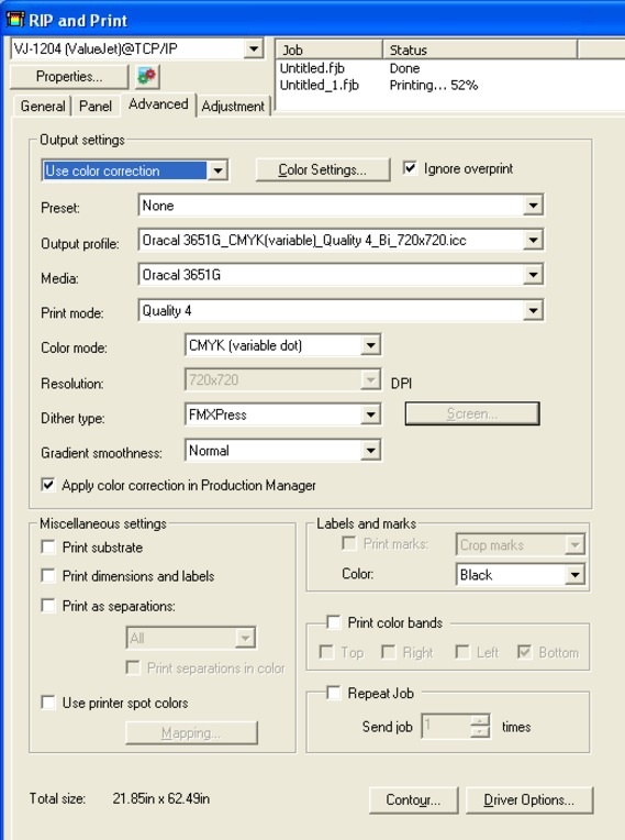

    What color profile are you using? for your output?
    This is what we use on our 1204
  5. David40
    David40 Member
    63
    Jun 6, 2012
    When you print the test sheet that's built into the printer it uses it's own profile that's part of the firmware. You do this test from the printer menu without even connecting it to a computer or anything. What I am saying is that it won't even print Red on it's own test sheet, it comes out Orange.
    That page you uploaded is one of the profile's I have played with, but to get close to a good Red I had to create my own with the Color Mixer using 5/100/80/5 blend that one of the posters recommended, but still it's not the brilliant fire engine red I'd like to see.

    Yes, I learned that you must use a spectrometer system if you can afford it or like I did you must print out a CMYK swatch table for whatever media you are using and regardless of what it looks like on the screen dial in the exact mixture of colors and they will print that way. This way I get exactly the colors I choose. CMYK is quite limited though in it's gamut if you look at a comparison chart. You can see from the chart that CYMK just can not produce colors outside it's gamut. Reds are very tightly limited and that is why photo printers use six different inks instead of four so they can expand the color gamut. Had I known this in advance I would have chosen a different printer with a wider gamut.
    You also need to make sure you have the color correction setting correct in the software. For vectors and text I have the color correction turned off.
    If you use Flexi do all settings from the Production Manager Jop Properties.
    I get some very decent reds using Orajet 3551G Profile and C=0, M=(90 to 100), Y=(80 to 90), K= (0 to 15)
