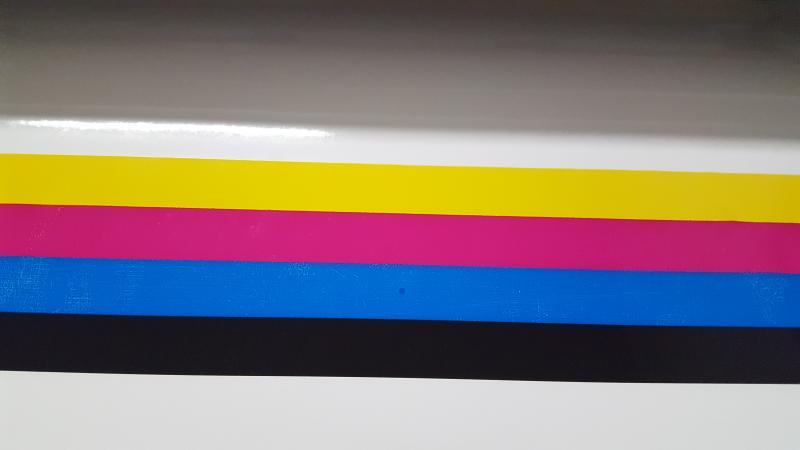

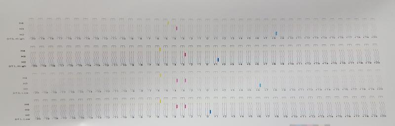

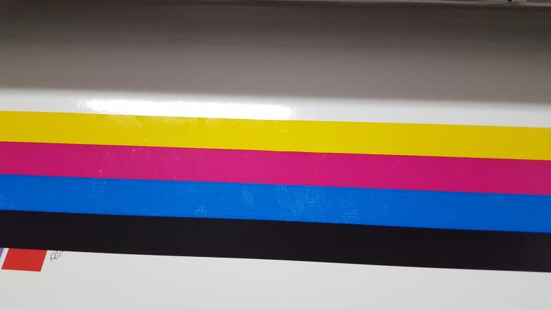

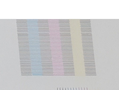

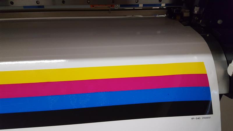

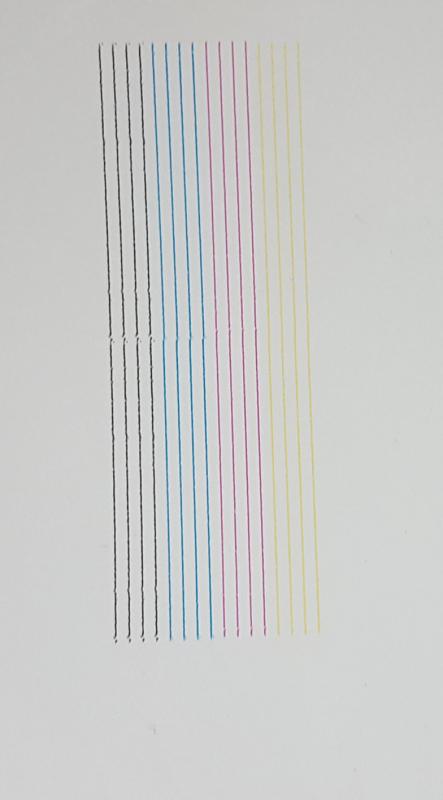

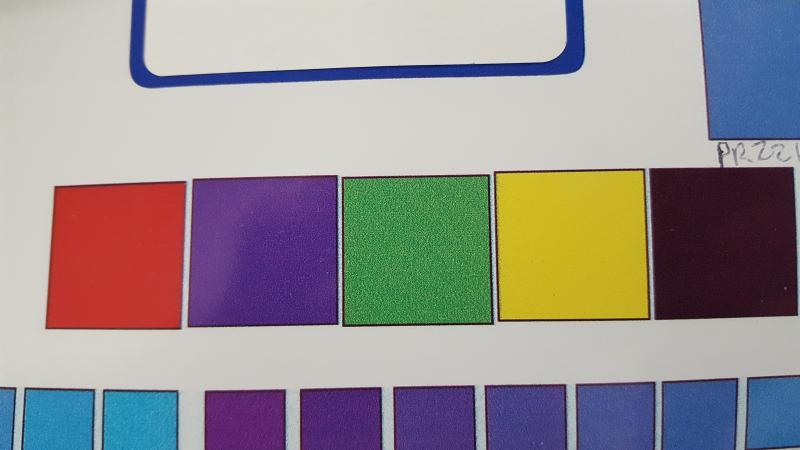

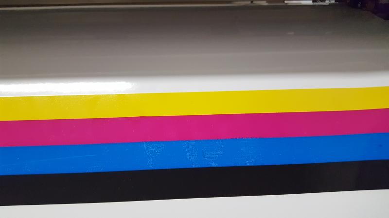

Here are some pictures of the test print. I am still trying to figure why my blue prints purple and my black is brownish red, black

Here is my original problem.
Colors not printing correctly Roland VP-540

could it be that you have switched off colour management? "blue to purple" sounds a little bit like that.
But you will never have best color quality without specific profiles.

CMYK from the fill pattern look normal, other than the finger prints :)
the test prints point to a head needing alignment though, notice how some colors are smooth, and others are gritty?
could be the dots are stacking on top of each other, instead of side by side. That can cause quite a color shift on its own.
post pics of service menu-print menu-head adjust-> Bias, vertical and horizontal.
may be under service menu-head adjust. print on something thin and glossy.

also for fingerprints, the printer can't print to the outside 1/2" or so, so just handle the material by the edges.
Ragnabrok
outside some deflection on black, everything looks lined up. I'd guess some type of odd colour correction in the profile or color space is causing this issue.
try the same file with generic vinyl profile, and pre-press US default.
