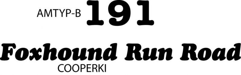

Thanks for all the help
here is a test i have done with both fonts that I use alot
AMTYP-B and COOPERKI is what signlab calls the fonts
again thanks for all the help

Your Signlab should have come with a Cadlink Fonts disk and a fold out wall poster with all the fonts listed. That list gives you the Cadlink names and what they match up with in the outside world. Many are close but have the odd difference.
Hope that helps as well.
