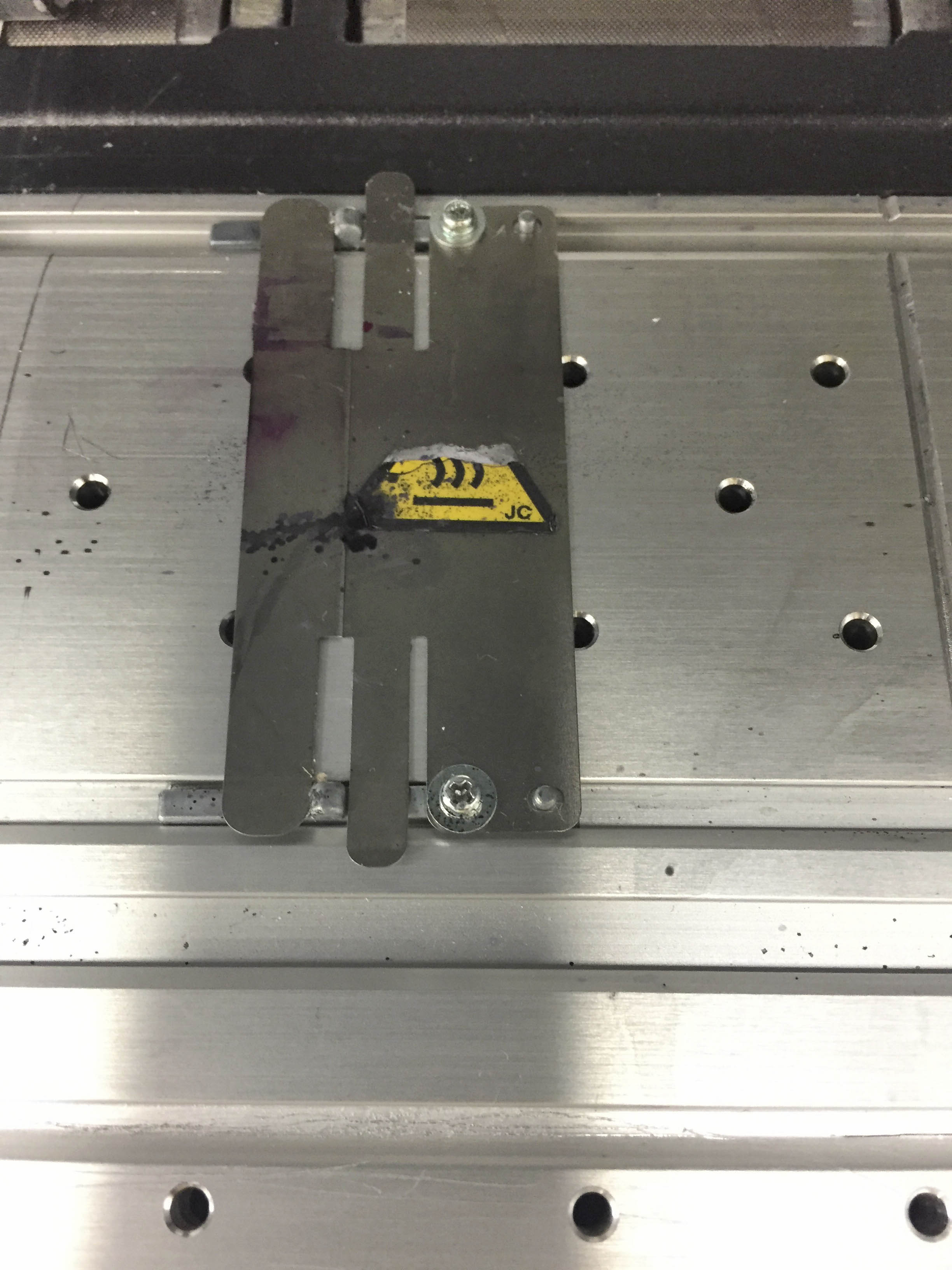

Hello everyone, this is my 2nd post,
I ve repaired a cjv30 for few days, it is working perfectly now ,
i haven't media plate when i bought the printer,
so i order 2 media plate, i ve received it 2 days ago,
but i don't know how to fix them, they don't send the screw i need with the media plate, is someone can take a picture of his media plate ( especially the screw used to maintain the media plate ), it will help me a lot.
Again , sorry for my english !
have a nice day,

I hope this helps.

damned , i don't have the 2 small slider piece under the media plate.
Someone know where i can find it ?

Get spares while you are at it... after you have had them for a number of years and taken the plates off the sliders a good number of times the soft aluminum screw holes wear out. Then again the slides are pretty easy to remove and once out just give them a light whack with a small hammer next the the screw hole and that tightens the screw holes back up too. :)
