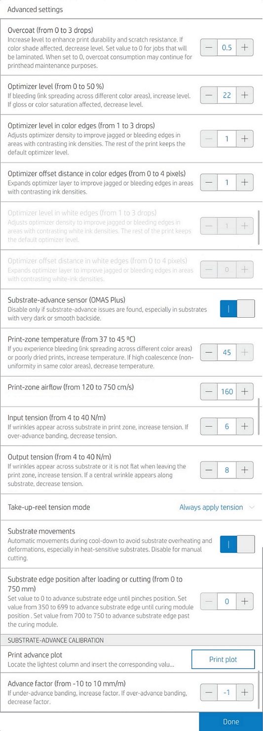

Recommendation now for wallpaper is to have Input tension set to 6Nm and Output tension 8Nm.
But now that I checked, it's more for tiling issues rather than size.
