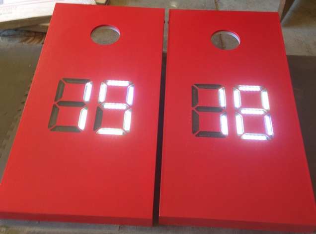

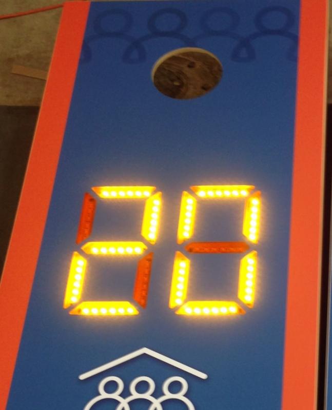

So right now my current process to apply the vinyl is print, cut, apply. However it's very difficult applying the front wrap after the vinyl has been cut. It's pretty weak around the numbers. (see pictures) The vinyl can stretch, wrinkle etc. I'm pretty good at it and very rarely do I make a mistake. But it does take a while working it around the numbers. Unfortunately I'm the only person at my shop able to do it successfully. Part of that is experience, but a lot of it is a poor process.
What I would like to do is apply the wrap over the entire surface, then cut while its on the board, and peel off the vinyl that goes over the numbers. I have a CNC laser cutter and did this pretty successfully, but then I read you should never cut vinyl with a laser cutter because of the offgassing can ruin the parts and bad to breath.
So I'm looking for any ideas to improve this process. Would be willing to spend money to improve the process, but not a crazy large amount. Even if it was some sort of crude stamp cutter. I'm looking to save time and make the process easier.
Any ideas would be appreciated.
The first picture is a printed vinyl wrap. That goes over the numbers. The second picture shows what the vinyl is cutout to go over. The red board is just painted, with no vinyl.
