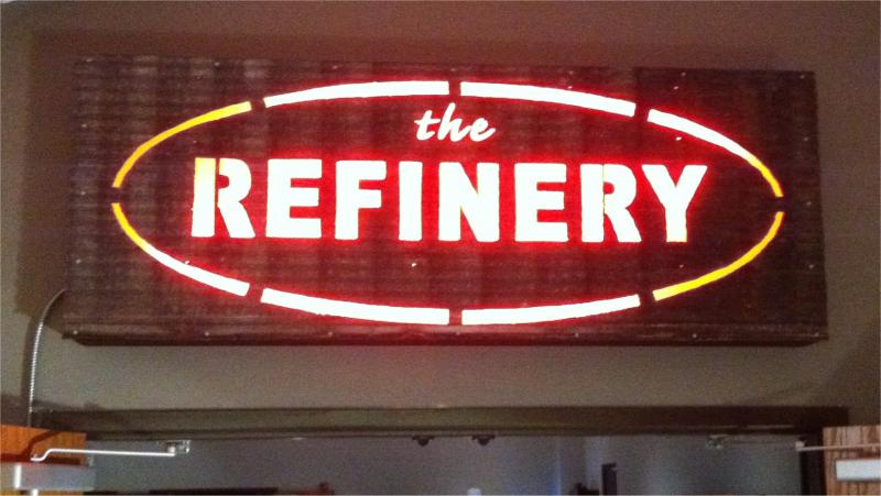

    Doing a renovation of the youth area at our church and we are going with a more "rustic" feel this time around. Found some old tin from a barn, and cut this with a plasma cutter from a template we laid down in vinyl, backed with translucent red on some clear plastic I found in my scraps, and backlit it with a couple of fluorescent lights. Came out pretty cool I thought for our first try at something like this.
