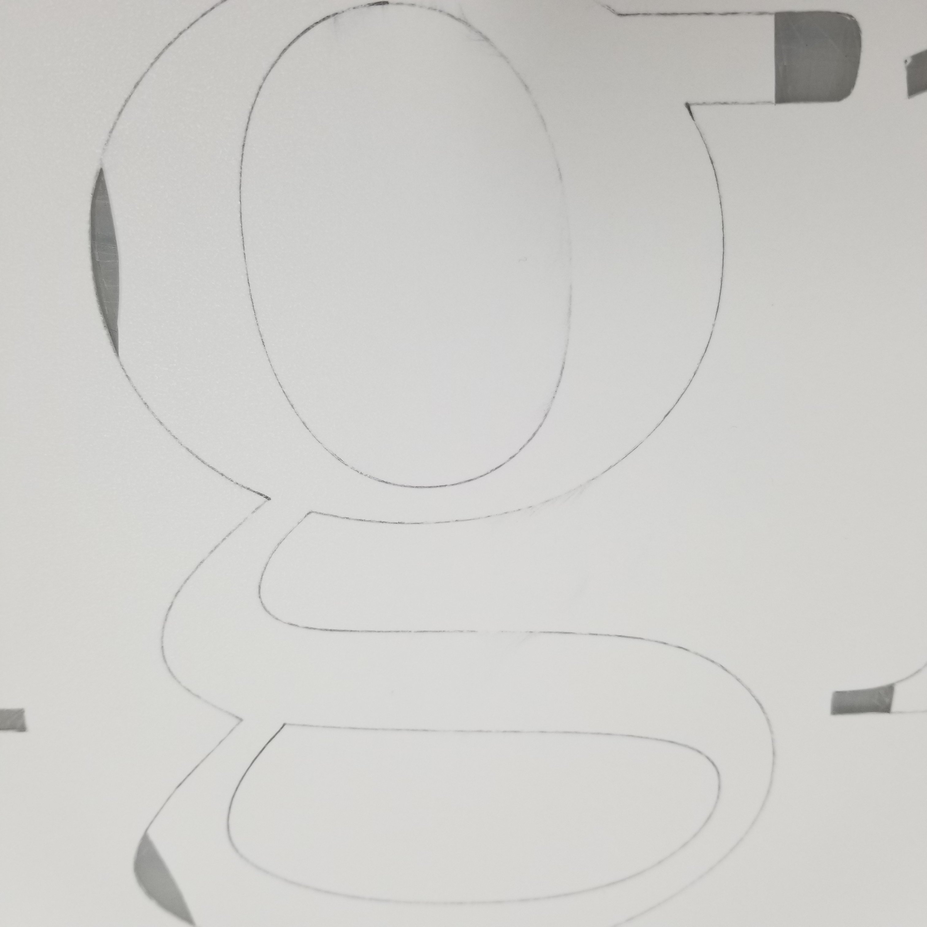

I am wondering if there is an easier way to notch a pattern than the way we do it.
We are nothing the letters by hand and when you have over 300 letters it is not as fun as you think it could be:eek:. Every suggestion is appreciated!

We use them as our pattern to put up individual letters like quotes and so on. Like this one IMG_20210111_173431_558.jpg
I know that you can cut of the top of the pattern and use it if you like to.

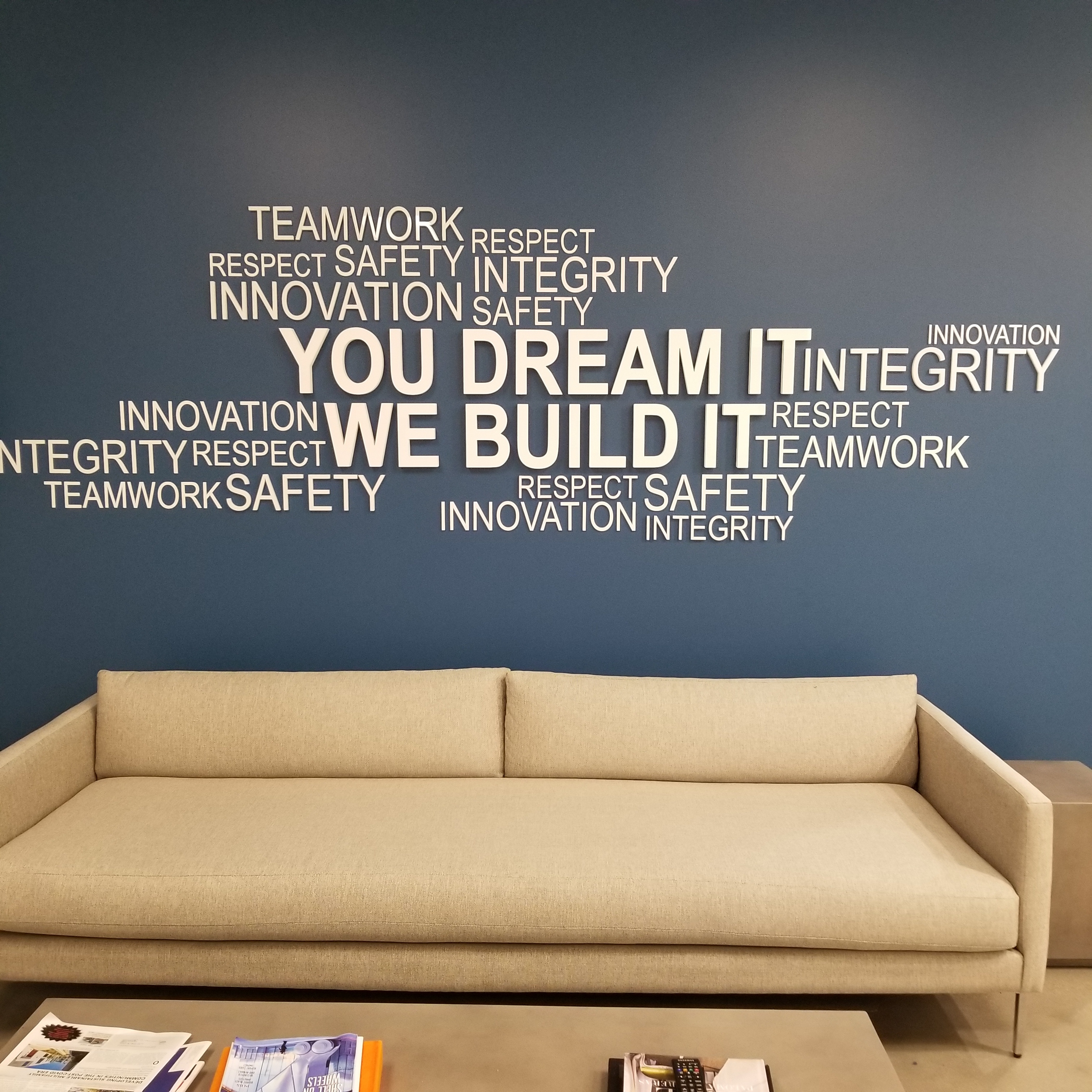

Forgo all the manual labour.... we laser cut acrylic for all our dimensional letters. We simply load some 3mm cardboard into the bed and laser that out with the letters. We can then check we have all the letters and package in the cardboard for very easy install with no hunting for letters - makes quick work on site. These are for VHB backed letters.
