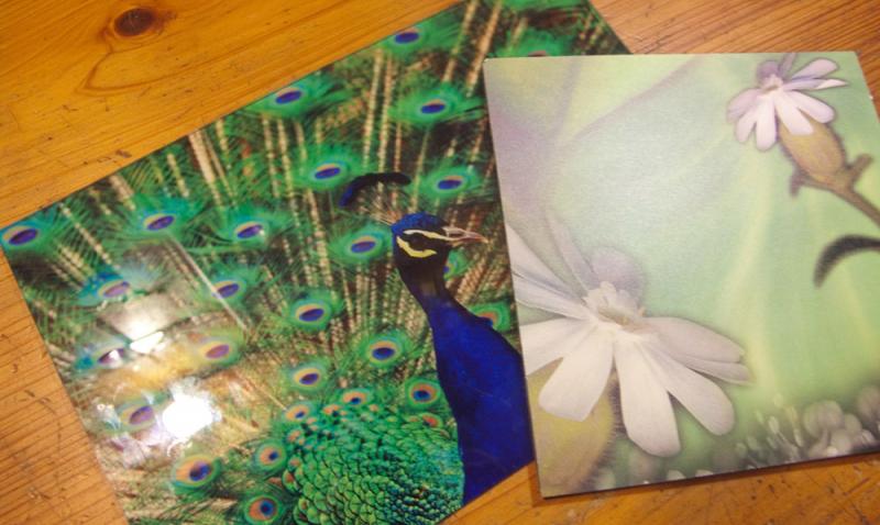

    here's the samples that i have been beating to death for my boss to show him that the ink can take a licking. they are pristine.

    nicky is a great guy. he's a PHD as far as printers go. the samples that i mentioned above were AOjet samples (a CET platform model). they looks spectacular and the ink is like formica.
