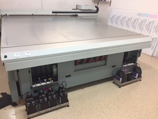

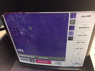

Hi we using right now, Nutec inks on our oce arizona 660xt, with no adhesive issues for the past year the good thing is the price only $210 for 3 liters, since we print all they long corrugated plastic we need a competitive ink price in order to compete with this market, we start using 258 inks and the adhesion comparing with the Nutec is the same, you may try to use an adhesive promoter or print in quality smooth in order to get better adhesion, I don't think you will have problem with the ink we use

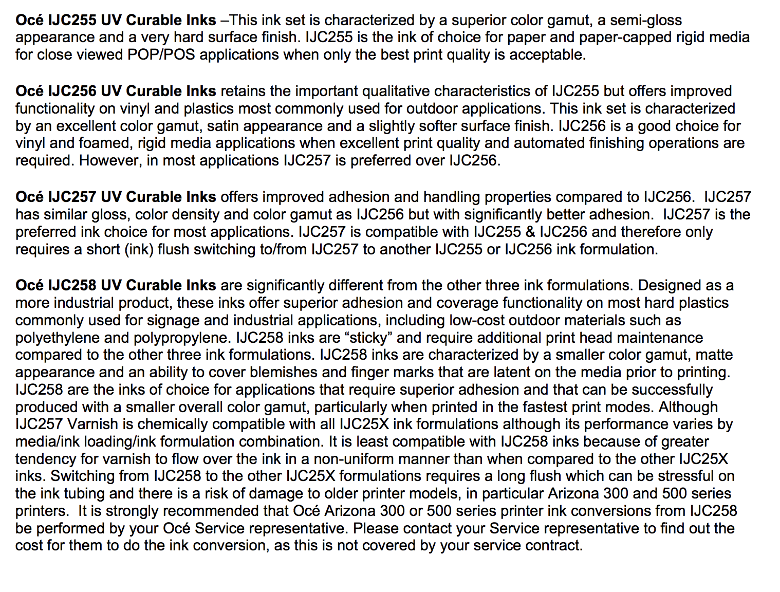

There use to be a buliten on the dgs.oce website but i can never seem to find it anymore. it would compare all the inks 255, 256, 257 & 258

Was this it?:

Yep, where did you find it?
