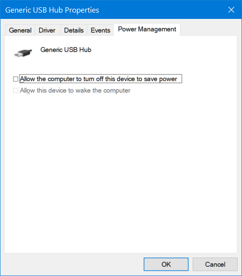

    I bit annoyed with Omega 5 right now
    First let me explain my work flow.
    1. I set up all my files and get them ready to output.
    2. The next day I print.
    Well sometimes all the files I had open close and I have to reopen them. I think its a fact that the computer goes to sleep. Than the USB key doesn't read and it must close.
    Is there a way to make sure that doesnt happen?
    Can I just have my dam serial key on the computer. I hate this dumb usb serial key.

    You might try going into your settings for USB devices and look for "Power Management". When you find them, uncheck the box which allows the computer to turn off power to them.
