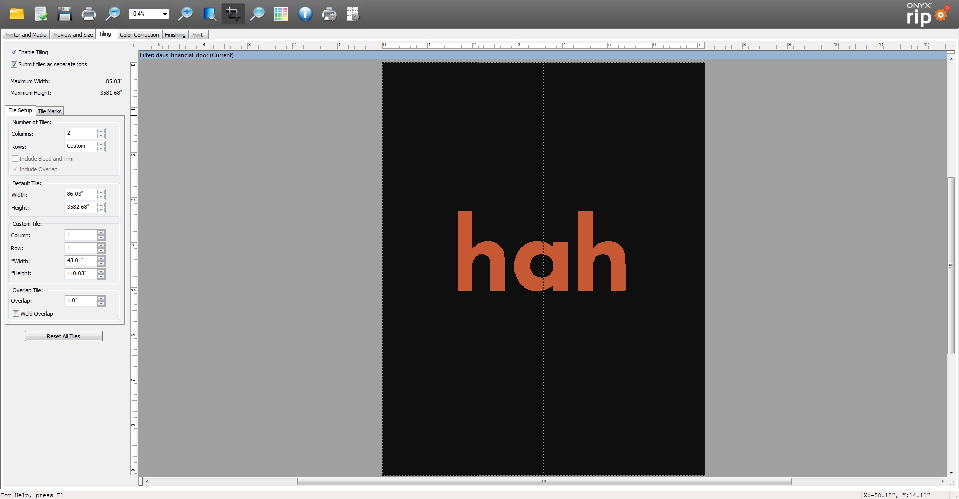

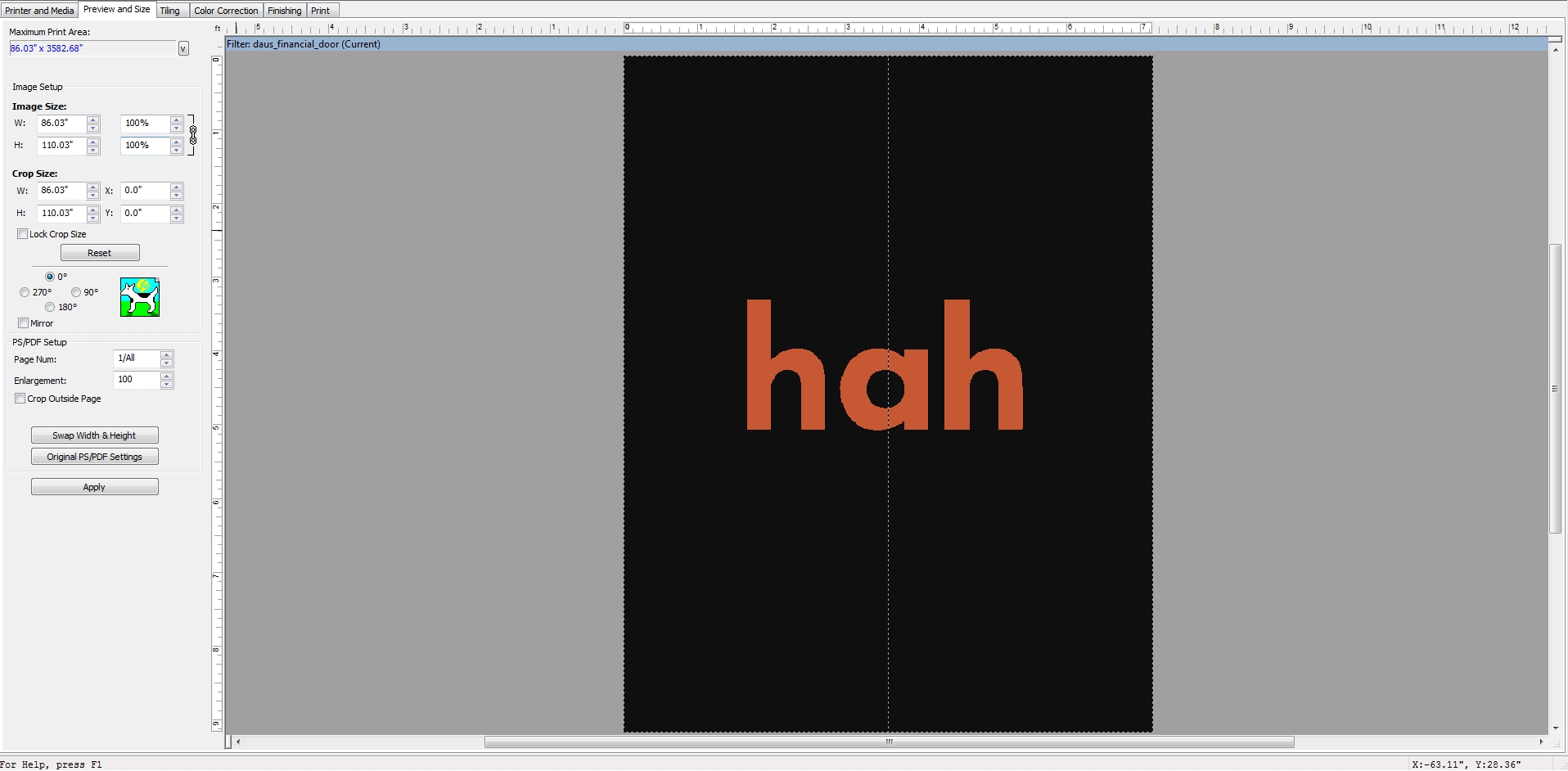

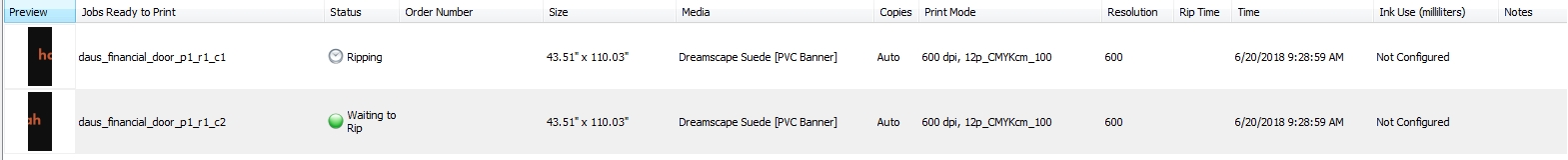

Here's an example of what I do, if it helps.
I made a dummy file, 86"x110"
Then enabled tiling and submit it as seperate jobs.
Then set columns to 2 and overlap to 1".
You can click on each tile in the preview window to see it's exact size if needed.
In this case it split them equally.
Then the last screenshot show the correct width of 43.5 for each panel. 1" of that is overlap.
