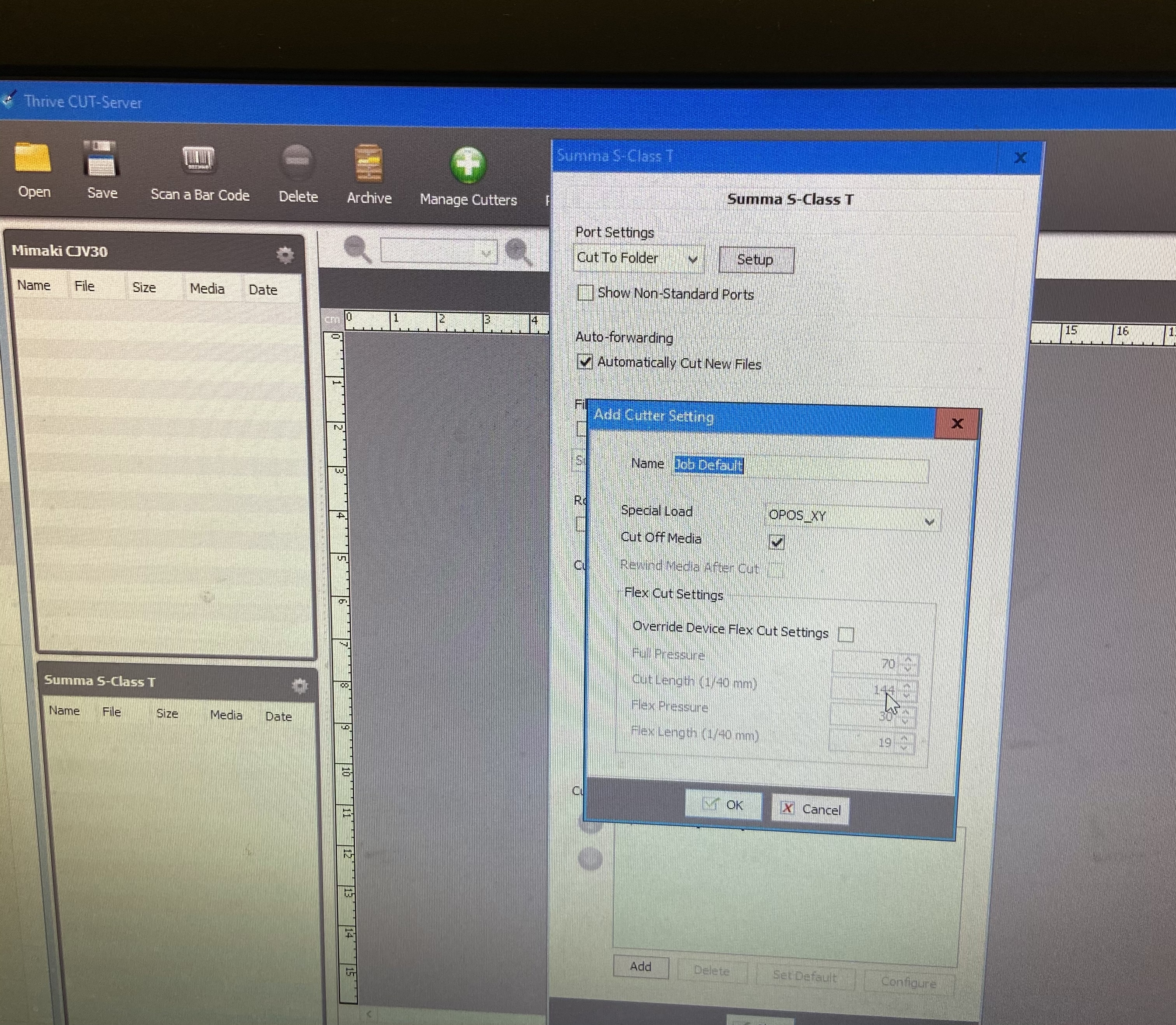

Yep we use that all the time. We load a roll on the summa, it’ll cut one job, read the next then cut the completed one into the basket and continue working unattended.

You shall find it here
iPrintStuff, I see you're sending the cut file to a folder, are you then using the Summa Cutter Control to start things? And the auto-cutoff and start next job are all automatic? So long as the 'Cut Off Media' is ticked in Onyx?

Just tick the "roll server" on in cutserver and you don't need cutter control. Onyx has it's own barcode server.

So we get onyx to create the cut file and send it to a folder, then we get summa cutter control to view the folder and use those cut files.
Haven’t tried just doing it in onyx so can’t tell you what that’s like. Our way is still very straightforward.

Tested the print/cut from Onyx to the printer and to a folder for the Summa Barcode Server. Summa Cutter Control did what I expected as far as cutting-off between multiple barcoded jobs. Sounds like having Onyx do this versus SCC do it is just half-dozen of one, six of the other, so for now I think I'm good. Appreciate all the tidbits.
