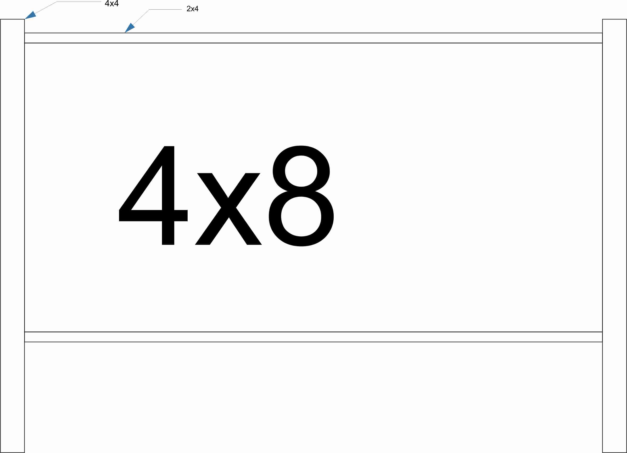

    Howdy all,
    Just wanted to get some opinions on how you build your 2 sided developer signage. I normally use a 4x8 sheet with slotted 4x4 posts with 2x4 on upper and lower. I cover the primed 4x8 sheet with printed vinyl. This usually works out well. Im just wondering how others do it. If I can find an easier way that still looks professional, I might consider it. It takes a few man hours routing the 4x4s and building the sign prior to bring it to the install area. Ive attached a little drawing of how I do it. I usually place a finial on top to add that little, well, whatever. lol. Thanks for the feedback. if you want to respond with some work you have done, feel free.
    Jim

    I use ACM. Since ACM is cheap, I use two single sided sheets. I put two 4x4 posts up and use "L" brackets on the inside of the 4x4s to fasten two 2x4x88" in the middle...so I have a frame. Then I just fasten the two ACM sheets to the on either side.
    Takes about an hour or hour and half from the time I pull up to the time I leave. Only prep before I go out there is just buying the lumber from Home Depot

    I like it and use a similar or the same approach on anything not deemed temporary. We like how all four edges of the panel are captured in the channels and makes for a far more rigid sign.
    Are you routing channels into the upper and lower 2"x4"s as well?

    I just put 2x4 cleats. Usually 2"x4"x6". Screw them 1.5" in from the edges of you sign.
    Since we now use ACM for everything i also put two 45 degree braces inside the sign. Screwed to the posts and crosspieces.
    When we used to use 1/2" plywood (Crezon or the like) you didn't need to put angled braces to strengthen the frame.

    I do not route the 2x4s. The side only keep it pretty rigid. A only use MDO. I feel that ACM is to flexible and can blow out or bend. I have had to go out to too many ACM signs and repair them.

    If you're repairing them then you're building them wrong. You have to use stringers for 3mm ACM.. 6mm you might get away with.

    Then Im using 2 sheets of acm. Ill just use a single sheet of painted MDO board and be done with it. Builder signs are temporary anyway. Not more then a year and MDO lasts well more then that. Works fine for me.
